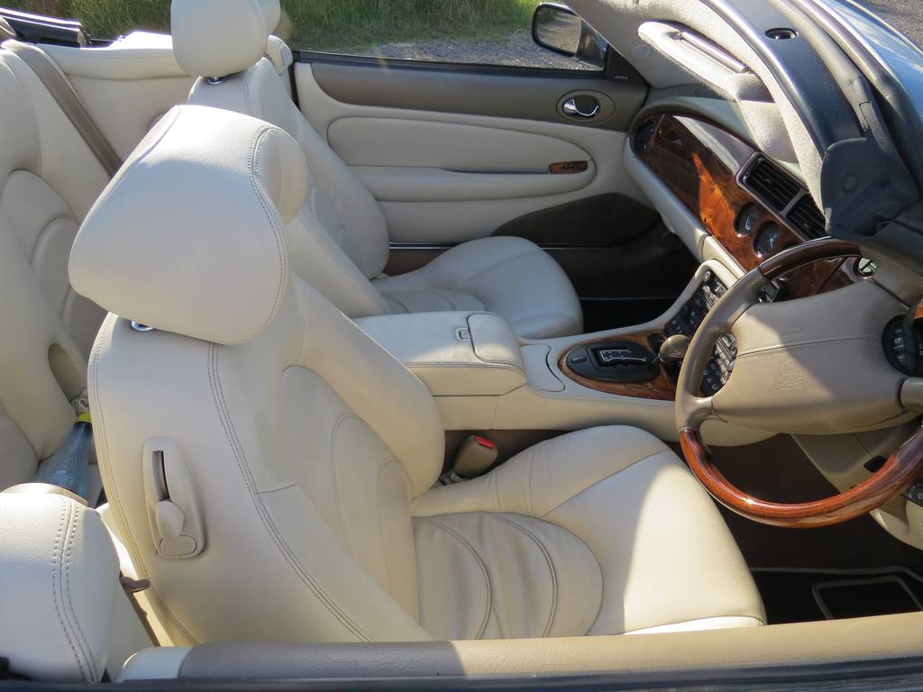

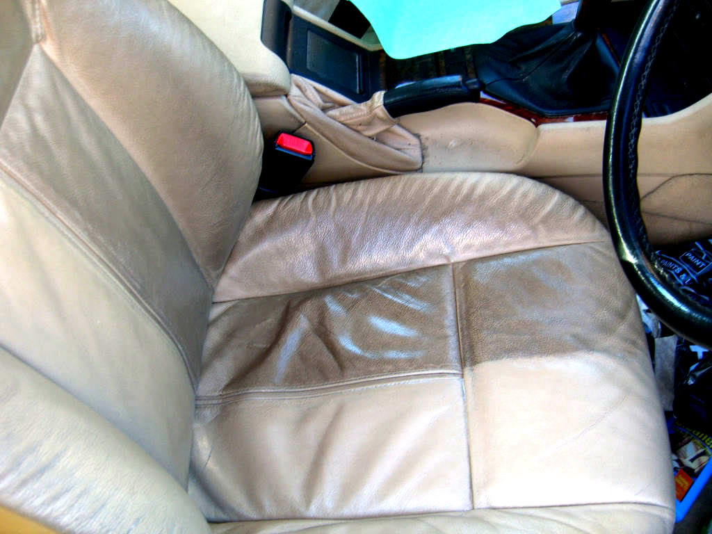

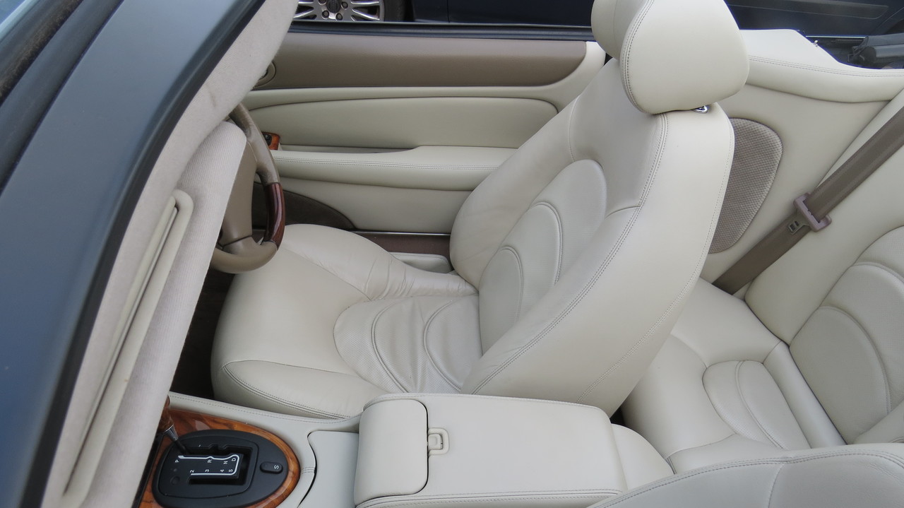

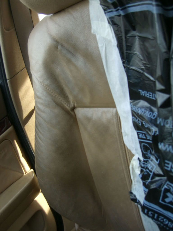

There are a lot of mixed opinions regarding the treatment of leather seats. I can only speak about what works for me. I use a good quality car leather cleaner, I accept the fact that others know far more about these things than myself so I followed the advice of these guys Leather Cleaners and use the Dodo Juice Supernatural. It certainly works. Then a good leather conditioner. I do my seats in spring. I give them a good clean. Repair and paint any damaged areas. Then leave that a month or so to set. On with a disposable rubber glove. Put on to the seats a good quality conditioner. Ensure its spread and rubbed in all over the seats. Keep the doors, windows closed on a hot day. Leave it overnight. The next day wipe off any excess with a terry towel and give the seats a good polish with another terry towel. It may sound immodest but when I have finished my seats look like new again, not to mention they smell lovely. Like new leather seats should.
If I can restore a seat like this...... (it was on a BMW) the Jag seats are a doddle.
And just after the clean up it looked like this
Last year my Jag seats looked like this before I started to do my annual job on them.

IVORY INTERIOR IN 2005 XKR COUPE
Frankc,
We have the same color combination Interiors.....I have tried to find the Color name and number of the Steering Wheel Leather and Dash but have been told so many different Colors that I have just given-up.....! Since you are the known Jaguar Expert on color combinations, I thought I would press my luck and ask you.....Do you have any idea?
