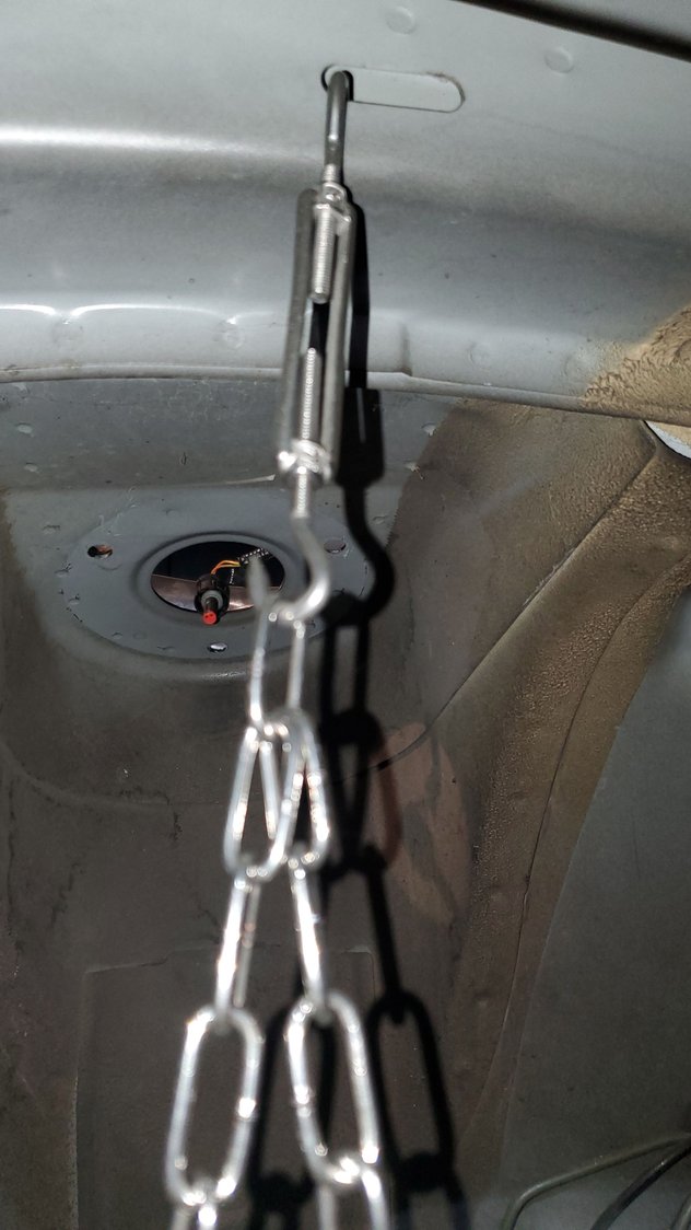

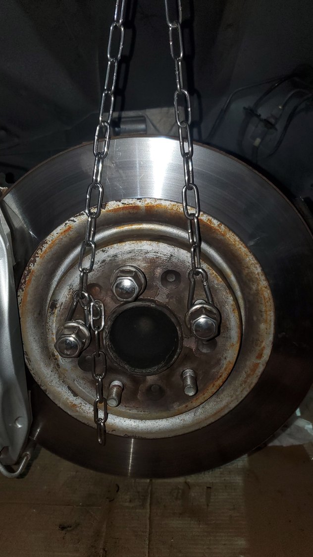

One of many ideas I've gotten from John at ToTheGarage was to use a chain hooked to the frame to hold the wheel hub in place while working on the suspension. I made a variant of it using a turnbuckle and carabiners for easy height adjustment and thought I'd share.
