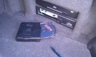

I was within 30 seconds of probably doing something to the CD player that I'd have regretted, but then.... from absolutely nowhere.... out she popped!!
The remedy was a knife (as in knife & fork), inserted between the cartridge and the white base, increasingly violent wiggles of said knife up & down, repeated pushing of the eject button and about 15 mins of patience!
I have no idea though whether the issue was the Doors album, CD5, or the machine generally. I guess there's only one way to find out...
