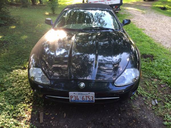

It has 147,000 miles, black with tan interior. Car looks good by the pictures and the owner says the car is in good shape. It's about an hour away and going to look at it this afternoon.
What should I look for?
I have read to start the car cold and listen for the secondary tensioners.
Is 147,000 to many miles for a '97?
Attached Thumbnails Chance to get a "97 XK8 ,200?-00808_4ka6zdguxaf_600x450.jpg   Chance to get a "97 XK8 ,200?-00606_cxck1ozqt5r_600x450.jpg   Chance to get a "97 XK8 ,200?-01616_47h6crbeelj_600x450.jpg   Chance to get a "97 XK8 ,200?-00o0o_jqshj96e0s4_600x450.jpg

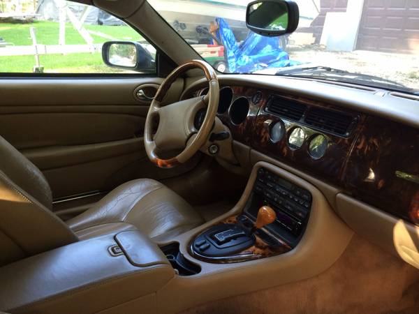

+1 on all the advice. It will need work at some point as it is 17 years old, when and what type are unpredictable (even a tranny service performed does not mean the tranny can't fail - ask forum member Gus!!!). Read the info in the stickies. The price is great, the body/paint look to be in good shape, I see the normal wear/tear on the driver's seat although center console looks rather pristine for the year, but if everything works when you test drive...................

The XK8 looks good in the photos and the background suggests the owner can easily afford to have maintained it properly.
It's still worth checking the service history and questioning any gaps. Also spend some time with the Drivers Handbook going through to make sure every control works. Some apparently insignificant electrical malfunctions can prove frighteningly expensive to rectify.

Hard to tell in the pictures, but the front end appears low. You should be able to get your fist between the tire and the fender. I think the stock height is ~15.75" from the center of the hub to the bottom of the fender lip arch.
If so, look at the upper shock mounts from the engine bay. If the shock bolt is off-center or you see the rubber deteriorating, then new mounts are needed. Not expensive if you can DIY.
