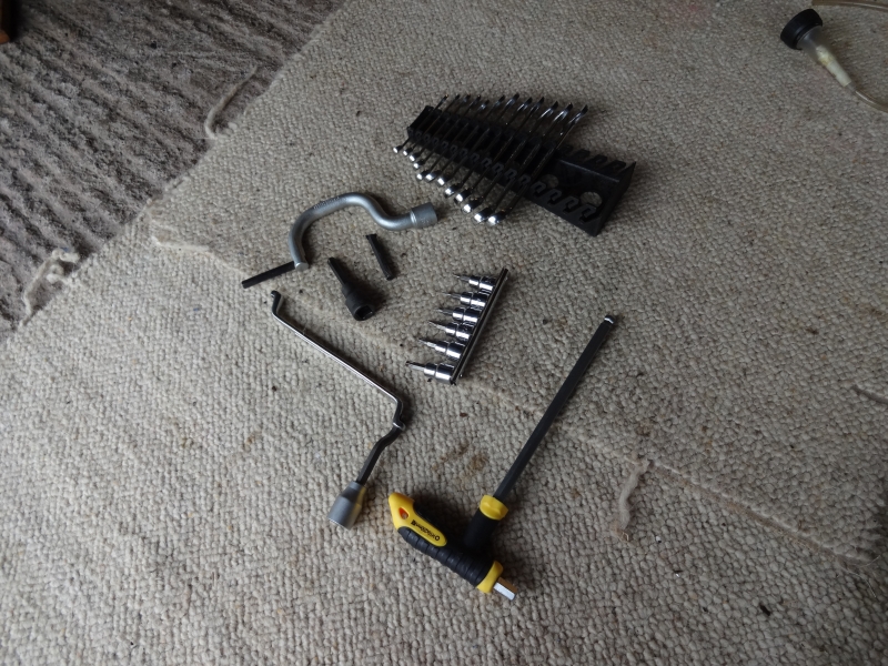

I had a selection of 8 and 10mm hex tools and a set of torx bits so I was ready.

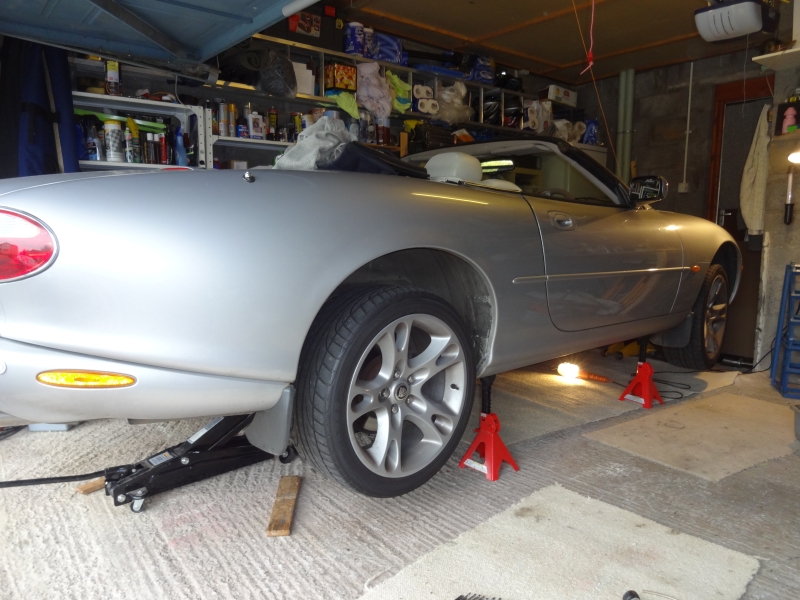

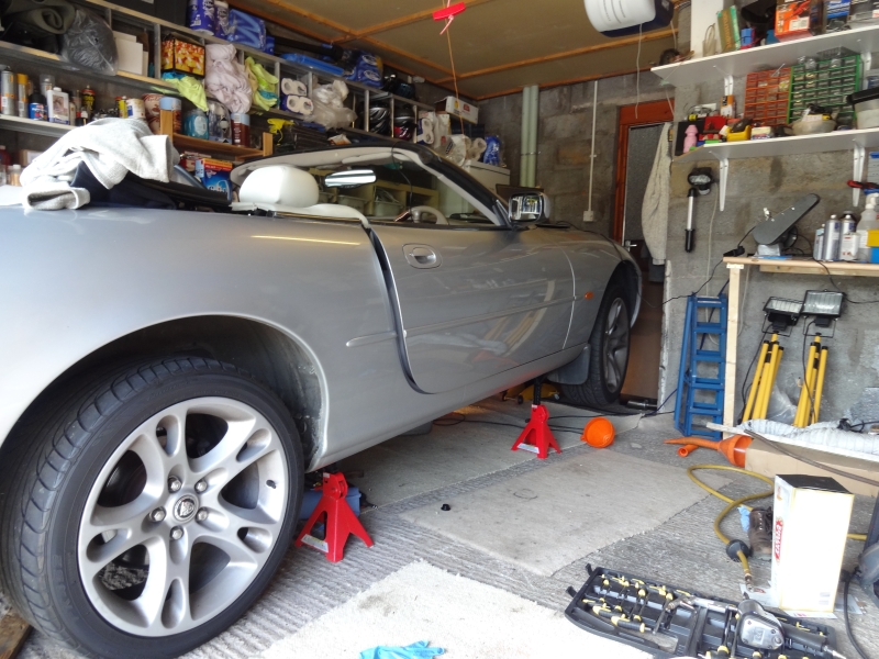

Got the car up in the air as far as I could.

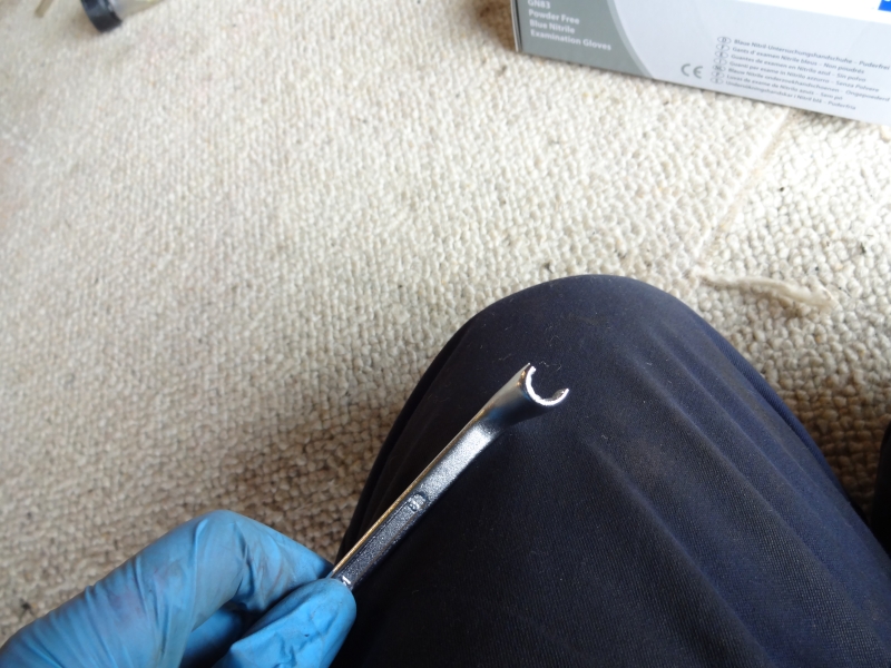

First I thought I would check I could release the filler plug, it was really tight, this is what happened to the spanner.
Luckily the second spanner held and the plug released.

I lowered the back of the car to drain out as much oil as possible.

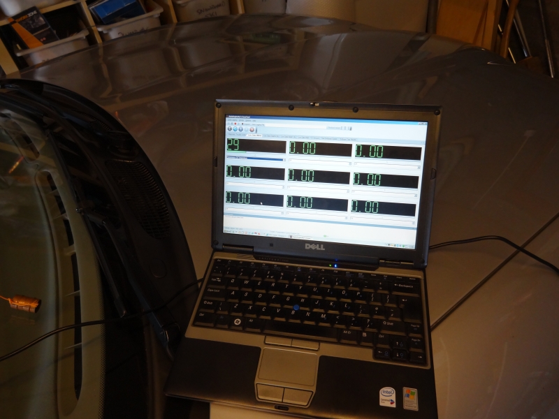

Then on to the refill, it took about 2 1/2l or so before I needed to start the car, then a further 3 l before closing off when it reached 40dec C.
