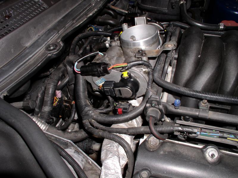

Originally Posted by doc18015
........... Where is the TPSensor? What do I look for or test?............
Following the theory a picture is worth a thousand words. The TPS is the black piece on the side of the Throttle Body with the yellow paint on the top securing screw:
Failure is not good news as others have already advised.
Attached Thumbnails Check eng. light and rough running-13-throttle-body-harness-plugs-reconnected.jpg

Thanks to all esp. Graham...picture works just fine for me. I am going to clean the connector and keep my fingers crossed!
will keep posted!
