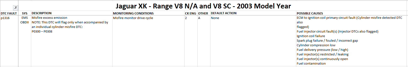

The P1316 meaning looks very wrong - anyone confirm?

From Jaguar 2003 DTC list, but 2004 is the same:
