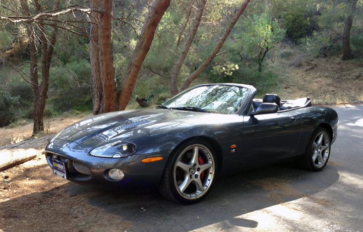

I'm a new owner of a 2004 XKR convertible. I've noticed a clicking sound from the left rear wheel that increases with road speed. Any ideas what it could be?
The car has large BBS wheels with trim rings. I read an old thread here that leads me to believe that the trim ring could be the cause of the click. If so, is there any risk in driving with it as is? Is it just an annoyance or can real damage be occurring?
