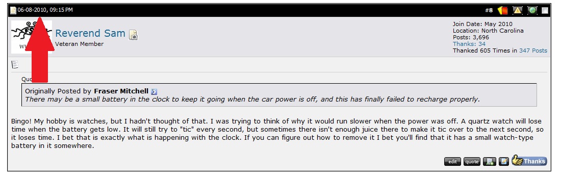

Old Mar 9, 2015 | 02:58 PM
Originally Posted by EZDriver
Where have you been, Rev! We have missed you. Hope you are doing well. How about an update.
Did you check the date on Reverend Sam's post?
It was posted in 2010
Old Mar 10, 2015 | 10:35 AM
EZDriver's Avatar
Joined: Dec 2010
Posts: 2,125
Likes: 279
From: Holly Lake Ranch, Texas
Attachment 107631
OH!!!
