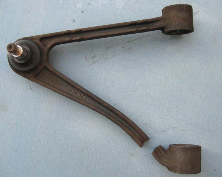

Old Jan 14, 2013 | 12:37 PM
sweatyfox's Avatar
Joined: Jan 2013
Posts: 47
Likes: 9
From: UK
Hi Kiphome,
Did you ever find out what the clunking/knocking was?
I had exactly the same problem on mine one day, but the cause was a bit frightening.
Wasnt the usual wornout balljonts or bushes, but a snapped lower wishbone!
I've never really pushed the car, always avoided potholes and taken the less bumpy roads. Was just wondering if anyone else experience this?

Old Jan 14, 2013 | 05:44 PM
NikasilNik's Avatar
Joined: Mar 2012
Posts: 175
Likes: 25
From: East Yorkshire UK
Originally Posted by sweatyfox
Hi Kiphome,
Hi Sweatyfox ,
I've know of several XK's doing this , it's caused by seized bushes , the wishbone can't move because the bush has seized so it flexes and cracks the cast wishbone instead , can cause a nasty accident !!!
........by the way , that's an upper wishbone , lowers are much , much harder to crack and break
All the best
NikasilNik
