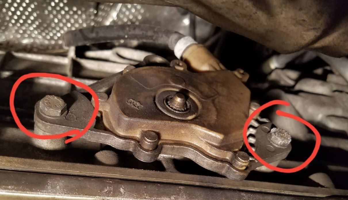

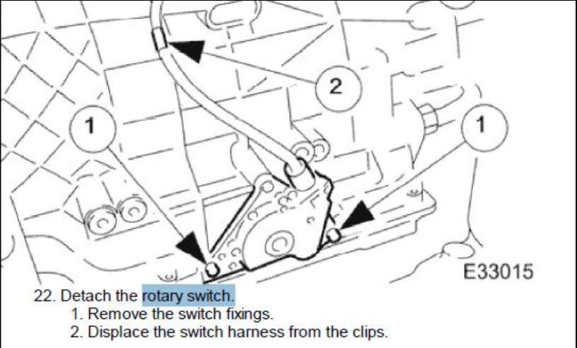

My 2006 XK8 won't start. It's throwing code P0853 "Drive Switch" malfuntion. For the life of me, I can't find the "Drive Switch". I got a "Rotary Switch", that is supposed to attach to the side of the transmission, but apparently, that's for older XK8s (which explains why I can't find it under my car, after HOURS of looking Doh!)
I'm pretty sure the car is not starting because this switch is telling the car it is not in Neutral or Park. I'm betting it's soe switch attached between the J-Gate and the Transmission, but before I crack open the console, I'd love to get an idea what I'm looking for.
Any suggestions what part I should ACTUALLY be looking for, or any suggestions what to do? Thanks in advance for any advice you can offer!
-James/ PYR8
I bought a replacement switch, but my transmission does NOT look like this.
Yep, very clearly shows a different transmission than mine.

I think you have the ZF 6HP26 transmission. That trans does not have an external range switch. Everything is internal. You're going to have to drop the pan in order to access the position switch. Take a look at the following link. They repair these, so I'd contact them first and discuss your symptoms.
