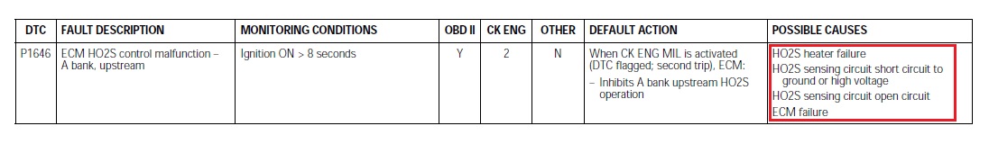

Here's the extract from the Jaguar DTC listing for your MY:
ECM failure is unlikely so concentrate on harness or sensor fault.
