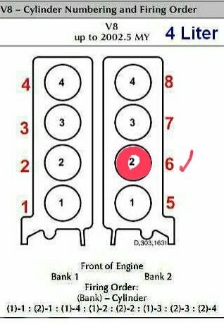

Hi guys,can anyone point me to coil D as I have a restricted performance issue and my diagnostic tool tells me it's a coil D problem,thanks

The code i am getting is po354,thanks,p's also says bank1 censor2

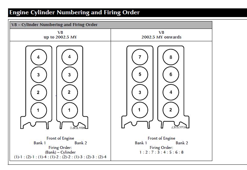

P0354 indicates a misfire on cylinder 4. The possibilities are a bad coil, bad wiring or a bad Engine Control Module. For troubleshooting remove the #4 coil and swap it with a different coil. Then clear the codes and run the engine and see if the fault moves to the new location of the coil. If it does then simply replace the coil.
You don't list the MY of the vehicle so assuming it is an XK8 I have attached the 2 different numbering sequences that were used for the XK8.

D is between c and e. Or #4

conflicting Information i am getting on various on line site's is that this is coil D but need 100% reassurance ,sorry for being a pain in the butt

I think what you have checked is correct for coil D, cylinder 4. I am sure that since the code reads P0354 that you are looking at the correct one. I think the reason for the updated cylinder numbering is to mirror what OBD testing identifies.

Originally Posted by graham11
conflicting information i am getting on various on line site's is that this is coil d but need 100% reassurance ,sorry for being a pain in the butt
this is correct. Aka 1,3,5,7 on the left and 2,4,6,8 on the right

The cylinder numbering post cracks me up. Only on a Jaguar diagram would the cylinder be labeled "2" on the inside "6" on the outside, but no that's number "4" for sure. ;^) (It might be "coil D" too !)

Jimmy, I'm going to give Jaguar a break on the cylinder confusion. It is really frustrating trying to figure out cylinder numbering or firing orders among many different manufacturers. On many common vehicles two different sources of tech info will give you two different answers or illustrations. I don't understand why these things are hard? lol
