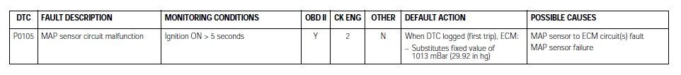

My copy of Jaguar DTC lookup for P0105 shows MAP error:
BARO circuit faults are P0106, P0107 and P0108.
