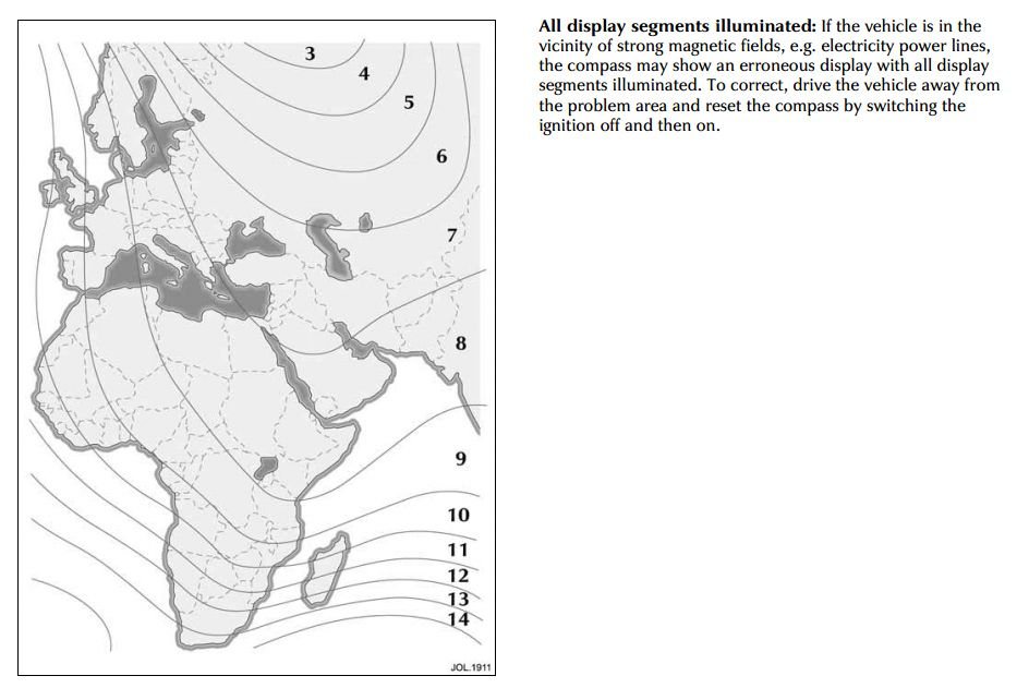

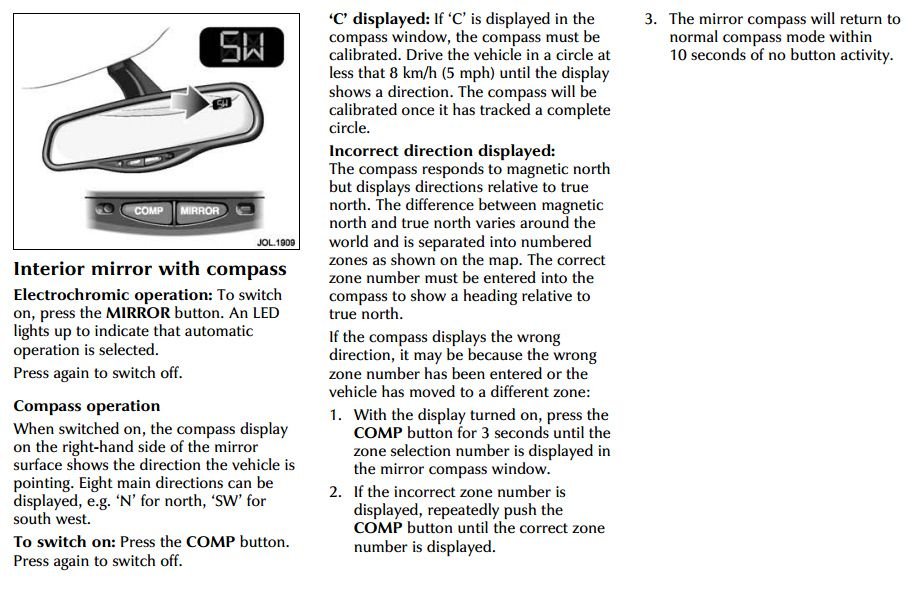

I've tried to reset the calibration of my rear view mirror compass. All I get now is "C" followed by numbers 1-15, presumably calibration zones (for the USA?) How do I recalibrate the compass for the UK (North east?)please
Old Mar 17, 2026 | 06:37 PM
Stumpy's Avatar
Joined: Nov 2011
Posts: 581
Likes: 208
From: Devon, UK
Here are the relevant pages from the Jaguar manual. Hope it helps ?
