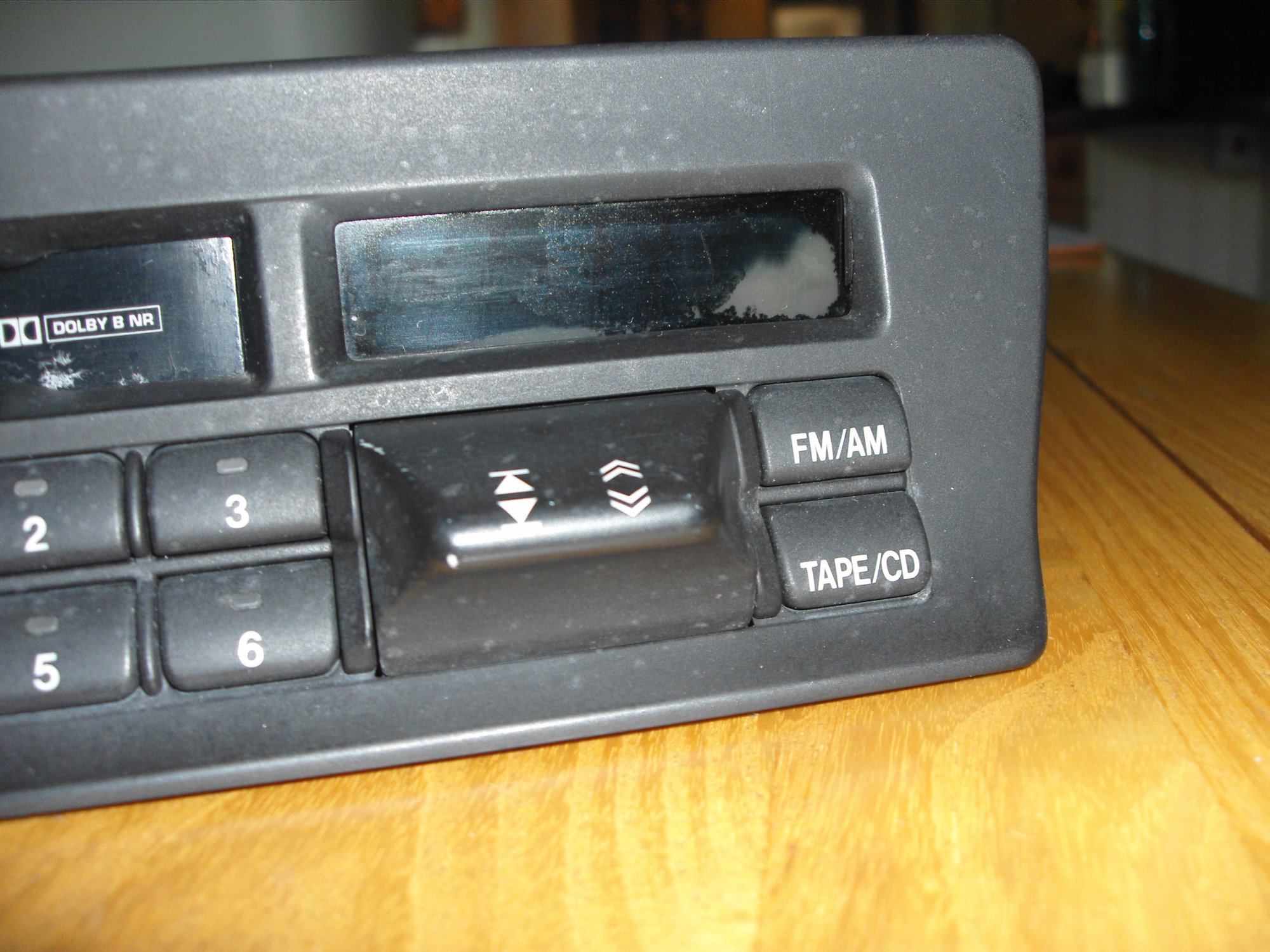

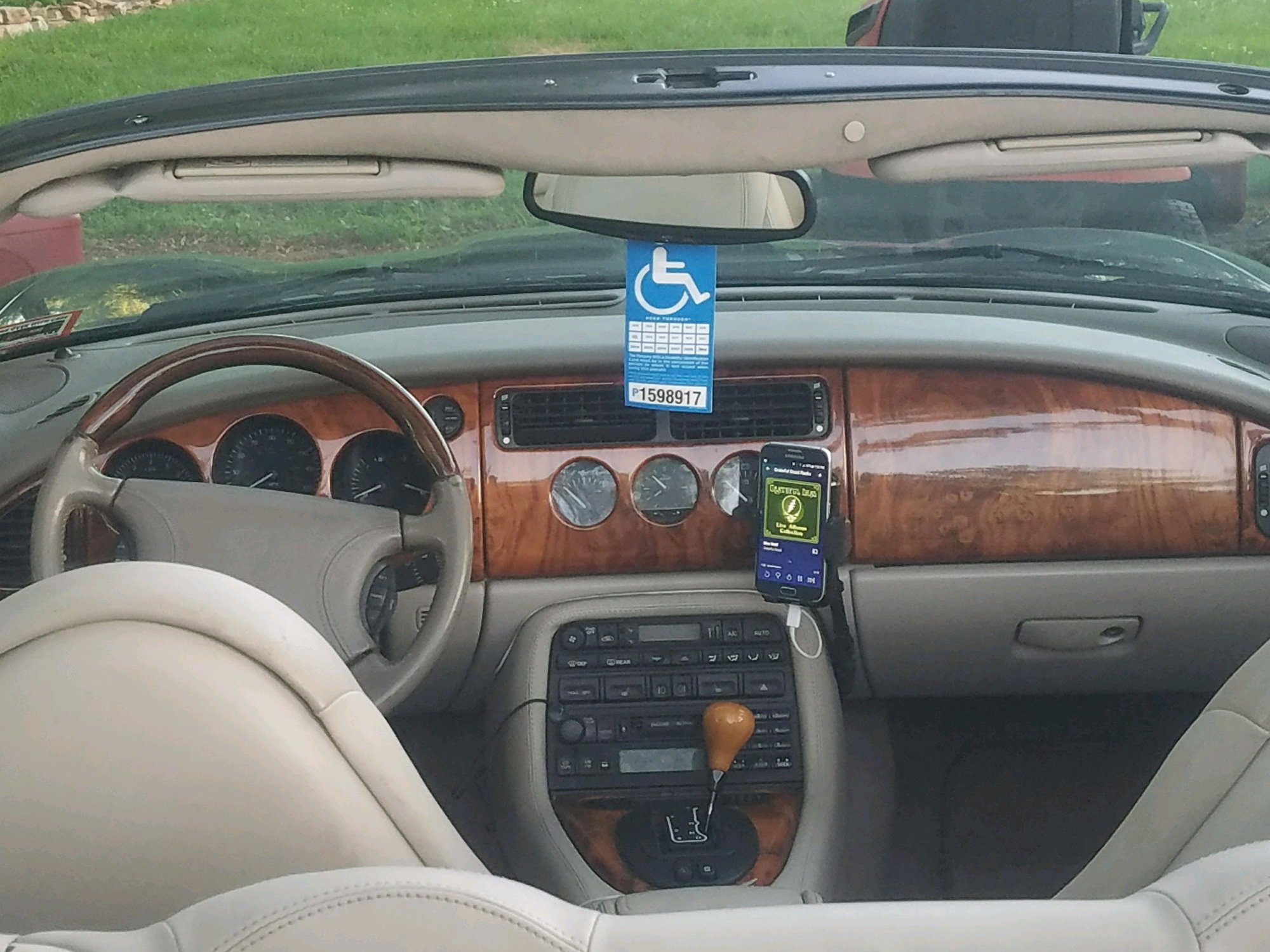

Premium has "super tweeters" in the triangle shaped area called a sail, front lower window corner. I forget if non premium has amp in trunk, but premium does.
from what I recall jaguar started the line selling Harmon Kardin head units then moved to alpine.
I forget the differences to look for but if you ever find the video of the jaguar introduction video given to new car buyers in 1996 and 1997 It shows the Harmon Kardin unit.
John
Zoom in on alpine unit
Old Sep 11, 2018 | 02:35 AM
DevonDavid's Avatar
Posts: 1,473
Likes: 655
From: Devon. U.K.
As above.
If you look at the photograoph, the head unit has the display in the centre. That's an Alpine head unit. The Harmon Karden head unit has the LCD display over to the right, and has a sort-of "joystick" button to change tracks or radio stations.like this :
If you have the little "tweeters" on the doors, you have the "Premium" system,.
There are significant differences between Alpine and Harmon Karden installations so none of the bits are interchangeable.
