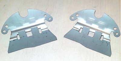

Hi. Is there a simple, cheap way of doing this without using beam-benders?
Any tips or info would be much appreciated.
Old Jan 27, 2014 | 01:02 PM
Replacement headlamps are frighteningly expensive although obtaining a used LH dip pair from the US is a lower cost option.
The direction of the dip beam is determined by a plate in the headlamp:
LH plates are available. Here's an ebay listing from one supplier:
JAGUAR XK8 XKR HEADLAMP LEFT HAND DRIVE 1998 TO 2006 | eBay
Alternatively, I understand RHD can be converted to LHD equivalent by cutting the existing plates but I don't have details.

Many thanks, Graham - anything must be better than repkacement of units!
