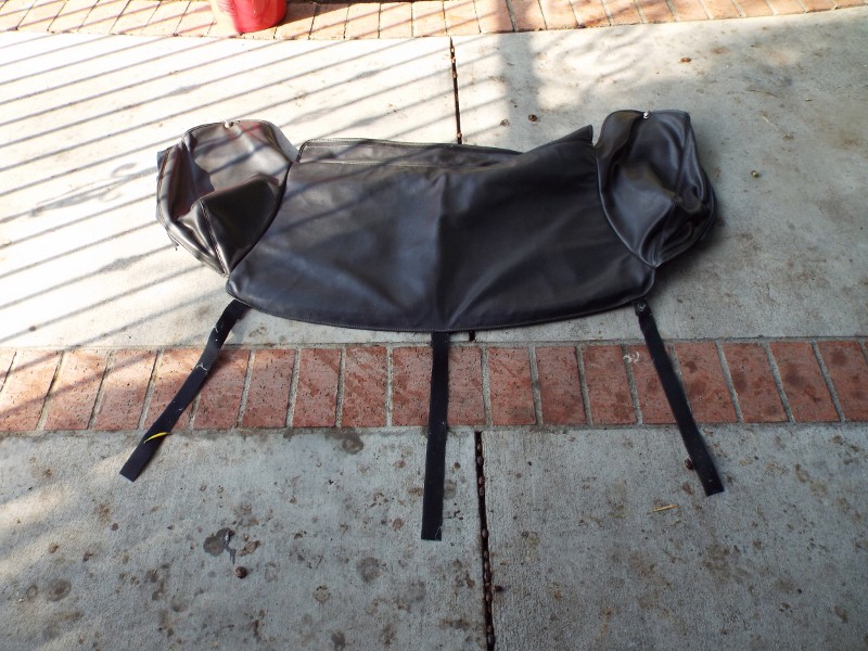

KCJagers,
I, too, didn't like the way the tonneau would catch air and ripple so much, so I attached three straps of 1.5" hook side of velcro to the three straps that tuck into the trunk and that hooks naturally onto the trunk liner, and I pull them very tautly so that there is little play. I also had sewn a strip of 3/4" hook velcro all the way across the front of the flap that tucks in behind the back seat. That strip naturally attaches to the velour headliner and sticks very well. There is nary a ripple even at speed above 100mph.
Attached Thumbnails Convertible Boot Cover Catching To Much Air-tonneau-tiedown-7-800x600-.jpg   Convertible Boot Cover Catching To Much Air-tonneau-tiedown-9-800x600-.jpg   Convertible Boot Cover Catching To Much Air-tonneau-tiedown-2-800x600-.jpg   Convertible Boot Cover Catching To Much Air-tonneau-tiedown-800x600-.jpg

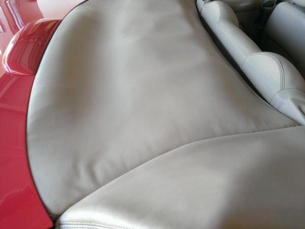

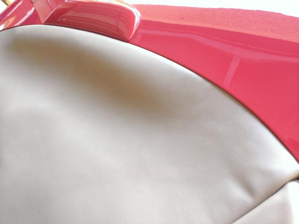

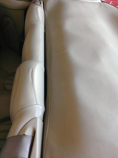

Here's some pics of my factory cover installed on the 2004. Mine is very snug under the boot lid.
I am curious if those who have flappers have different gaps.
Also wondering if the tops are going completely down.
Also wondering if there was a significant change to the rear bodywork causing a different air draft pattern.

Here is what mine looks like after 30 miles of highway speeds.
It never seems to lift up. If anything it appears to press against the top removing all the space between.
