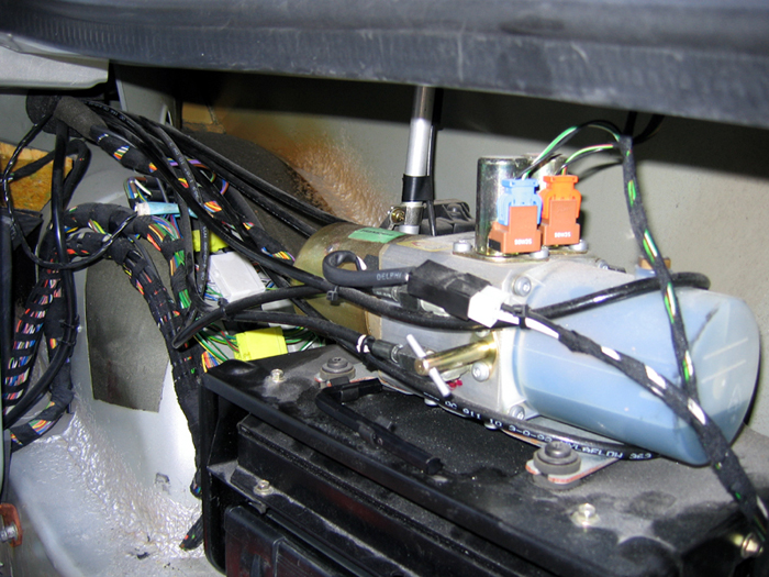

forum, does anyboby know where the key to close the top just in case theres a problem is. is it in the back of the car in the trunk by the motor for the top ?
Old May 28, 2014 | 10:59 AM
Posts: 121,069
Likes: 6,652
It should be you can see it here.

Mine was missing and the clips are broken. I bought a #8 allan and used some handy black tape to secure it. Now there's nothing to break.

now i see where it is............. thanks NORRI hope mine is there too......

I forgot there was even a tool provided and Dug in my toolbox until I found the right size, then when I topped off the fluid, I saw it.

Norri, your fluid looks low. Are you in the middle of a re build???
