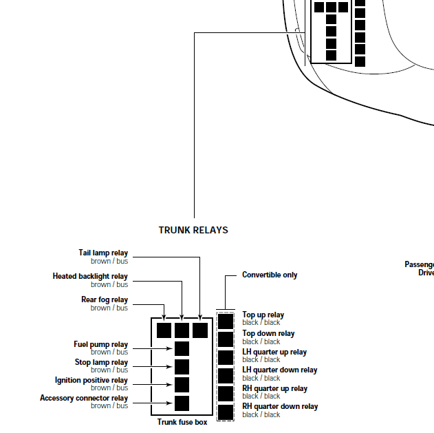

I have checked fuses, fluids, hoses, reset the system via the battery, manually raised and lowered the top, everything I could find on the forum. I checked my fuse box for the jumper switch someone had posted for raising the rear windows but my fuse box does not have that jumper.

If that fails, you can use the electrical method. Based on your comments, are you saying the fusebox does not have the same relays that the instructions identify you need to jump? If so, if you post a photo of the inside of your fusebox we still might be able to help.

To force rear quarter windows, you have to remove relevant relay and jump the connections.
