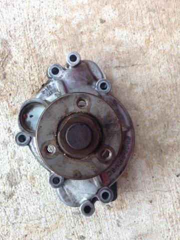

When I started unbolting the old water pump I had a sick feeling I'd bought the wrong pump since there were 2 extra bolts on the old one and they looked quite a bit different. But turned out the old pump was a 2 piece unit while the AC Delco was one cast piece.
As you can see by the pictures the old one also had a plastic impeller (yuk!) vs. the cast iron one in the Delco. So a nice upgrade.
