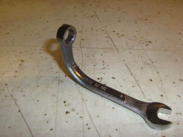

I have a leak around my plastic thermostat housing somewhere and am replacing it. I ordered an aluminum thermostat housing and uroparts upper and lower hoses (uroparts was recommended because it is thicker than avg hose).
I'm half way through the process and it's easier than I thought. I'm waiting for the 8mm (absolutely required!) crowfoot wrench so I can finish.
