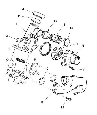

Would anyone know if this part is made in metal and where I could buy it.
I have looked at many sites but can only find the plastic part
Thanks

Not quite sure sure what part you mean, but the only metal replacement is the thermostat tower. Maybe the crossover pipe, or the reservoir? They last many years, but you're past the limit now.

Originally Posted by rsdmitch7
Would anyone know if this part is made in metal .....
Mitch,
Give us a clue. Pick a number ......

Originally Posted by GGG
Mitch,
Attachment 211824
It is part # 9

Originally Posted by NBCat
It's part # 9 in Graham's diagram
Thanks
Mitch
Thanks
Mitch
That is the water outlet pipe and is not available in aluminium.

NBCat; Thank you for the info. I will replace it when I tare the engine down to do the tensioners and chains.
Mitch
+1
I haven't found an aftermarket aluminium one on this side of the Atlantic either.
