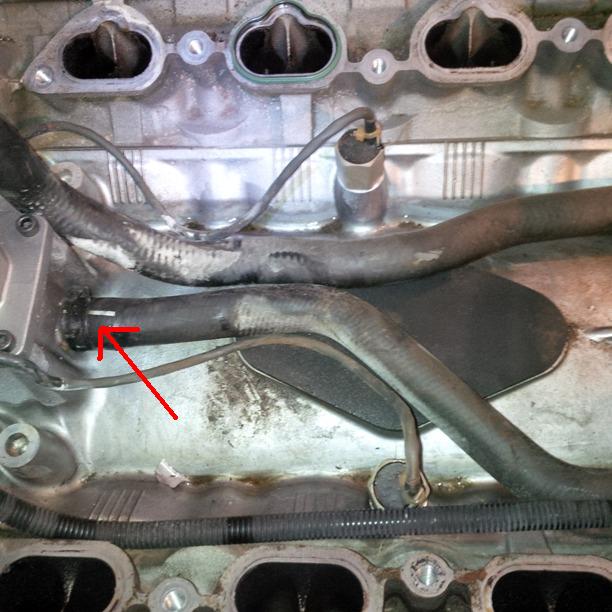

Old Jul 28, 2016 | 06:12 AM
Fulton's Avatar
Posts: 1,847
Likes: 696
From: Atlantic, Canada
yep, that's were mine was leaking when I bought it.

Old Jul 28, 2016 | 03:49 PM
brgjag's Avatar
Joined: Aug 2008
Posts: 2,904
Likes: 364
From: SW OH
still blows my mind that those hoses are there. No other way to route that so you don't have to take off so much to replace them.
Old Jul 29, 2016 | 06:19 AM
Fulton's Avatar
Posts: 1,847
Likes: 696
The good news was once I replaced the Valley Hoses, Octopus Hose, Thermostat Tower, Water Pump, Overflow tank and various other hoses, she stopped leaking completely.
However, I still get a twitch in my left eye when I smell coolant.
