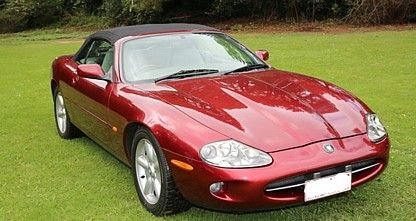

Michaelh
Re 1996 XK8.
Thanks for th reply. I measure 385 mm so as I suspected, the springs are 'tired' and the tyres occasionally touch on the liner.
Replacement springs seem unavailable in Aust. so I will investigate having the old ones reset.
Who might have a specification for heat treatment and does anybody know the free length of the front springs.
208000 km. Apart from the springs it runs like a charm.
Old Jul 9, 2025 | 07:53 AM
michaelh's Avatar
Posts: 4,792
Likes: 3,005
From: Jersey, Channel Islands
Originally Posted by mountain
Michaelh
Re 1996 XK8.
That measurement seems to be in-spec?
Perhaps it's the shocks that are tired at that mileage. Also, check the condition of the lower shock bushings and, particularly, the upper shock mounts.
There are two forum members (cjd777 and baxtor) who have collaborated to produce replacements for the uppers, and baxtor is also located in Oz.
I'd drop him a private message as I'm sure he will be able to offer you some good help and advice.
Beautiful car btw - and my favourite colour.
