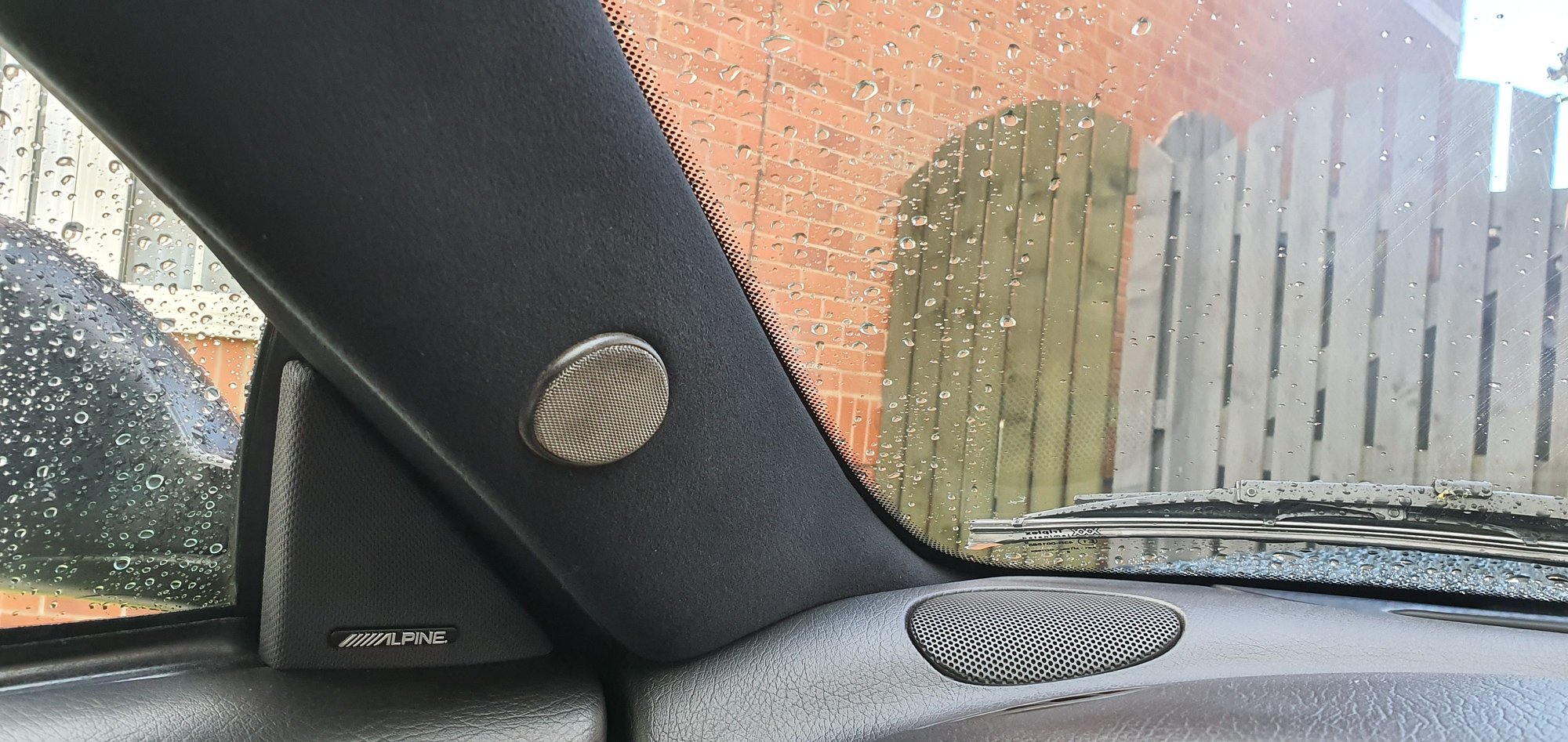

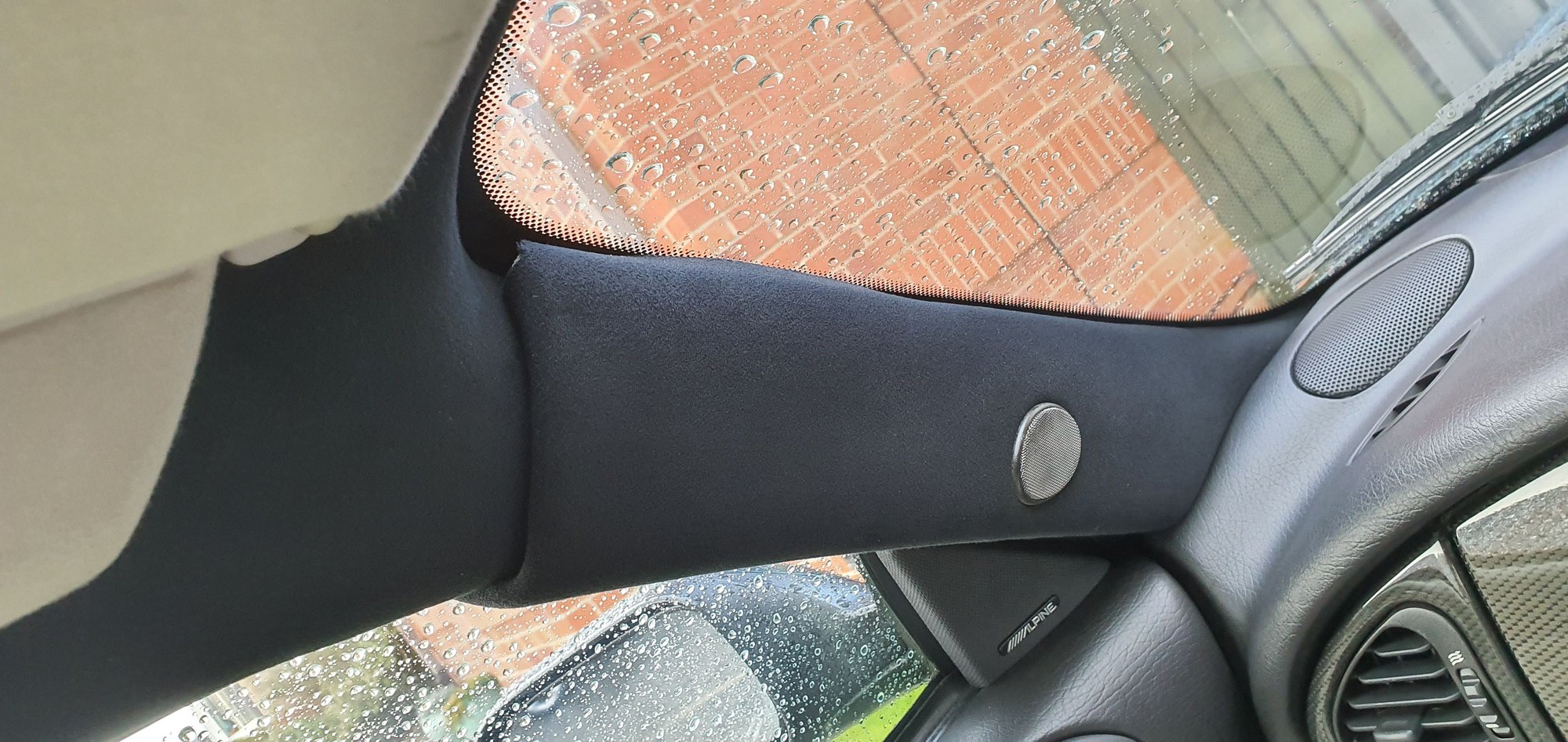

Hi
Can anyone help please.
I have shot looks like a speaker or something on the driver side pillar but not on the driver side.
Want to see what this is as getting new headliner etc. and can see what it's for.
Any help would be appreciated.

probably a mic for the hands free? My car had one but it was up by the visor

I think you will find that is an occupancy sensor.

Cheers Frank
Typical of jaguar to do on one side as doesnt do my OCD any good.

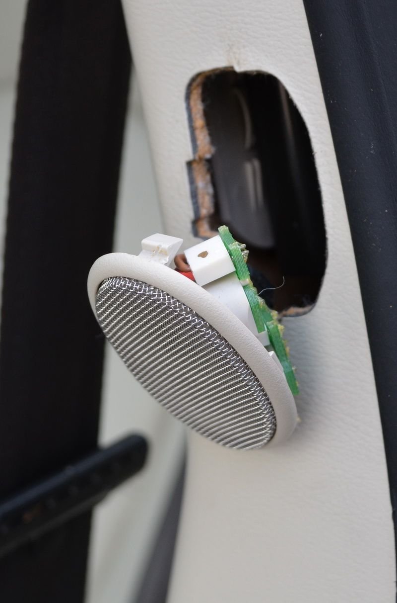

I don't have a photo of that sensor but one of the other Occupancy Sensors on my 2005 XK8.
Same design. The photo shows the retaining tab which has to be pressed down to release the sensor without damage. A credit card pushed down between sensor and trim does this easily.

It removes easily. Usually from the other/inside of the A pillar. If you do a search on Youtube a guy nick Rev Sam has done a video on its removal. But it really is straight forward.

Airbag deployment.
Guess that would be superfluous for drivers' side

It checks whether the passenger is too close to the airbag for it to be safe to fire it in a crash.
Get your passenger with seat belt on, to lean forward and the airbag light in front of him/her should come on showing it is disabled until they sit back
Similarly, if you connect the passenger seat belt with a lightweight passenger, or no passenger, again the warning light should come on and the airbag is disabled.

that occupancy sensor likes to fail when it is disturbed during removal. do not fret, a new one is available, otherwise treat it gently.
