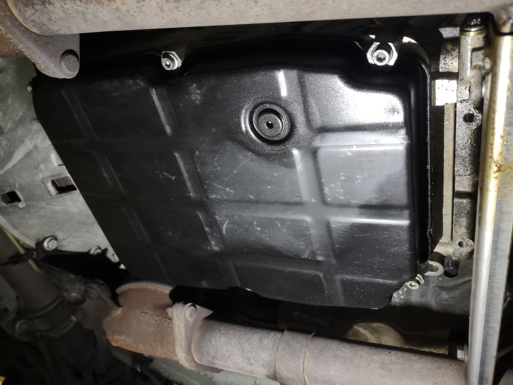

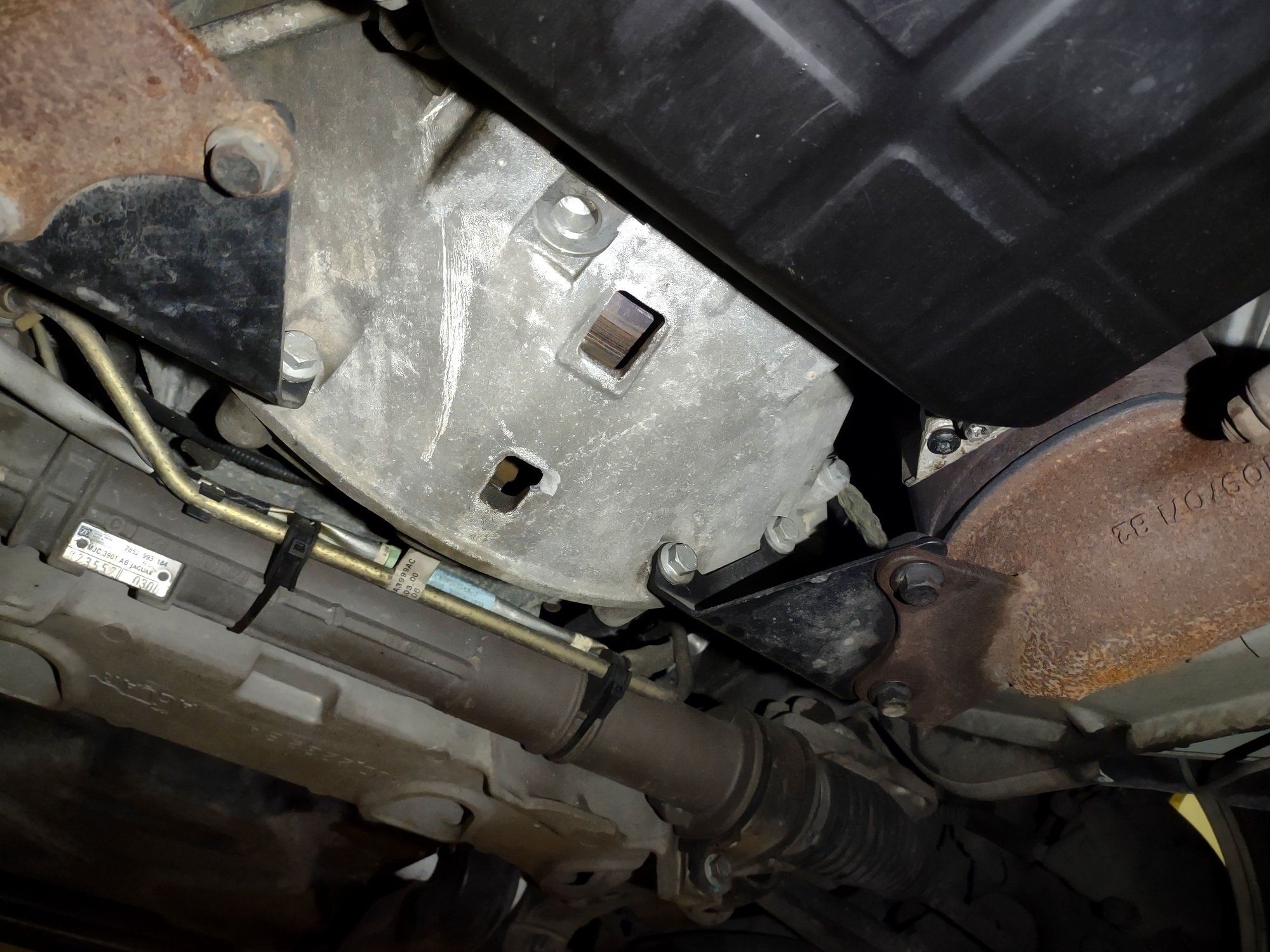

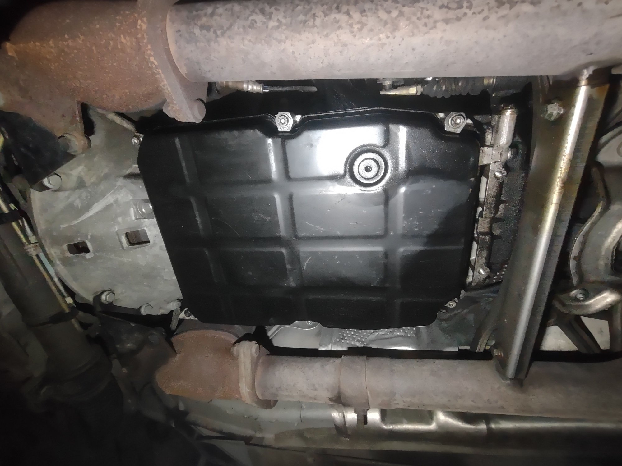

Update: I lifted the car and found the sump a little wet, so I decided to do a complete service, new gasket and filter, and new wiring harness connector. I'll purchase the Febi Bilstein kit. My car has the torque converter bolt access. Here's some pics:

Over tightening the pan bolts will cause leaks.
Z

I'll replace the bolts that are included in the kit, and I will apply the correct torque. I'm meticoulous .
Z
l recall my pan bolts secure little "rotate to hold" hooks, gasket can't be overtightened.
Interesting. maybe a year specific feature. Hadn’t found those on my 2002 XKR transmission pan or lower engine oil pan.
Here you go. They hook over the folded rim of the pan and seat directly on the body of the housing, there are no holes in the pan itself.

The same as mine, you can overtight the bolts, but the gasket will be always compressed in the same way.

Hi, yesterday I started draining the transmission oil. This evening I will continue replacing pan gasket, filter and connector housing, which I have seen it will be difficult due to the position behind the rh cat. I will keep you updated..

Remove the cat support bracket.worth the effort.
I will, thanks for the advice.
