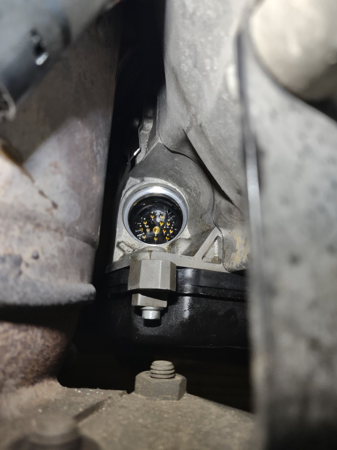

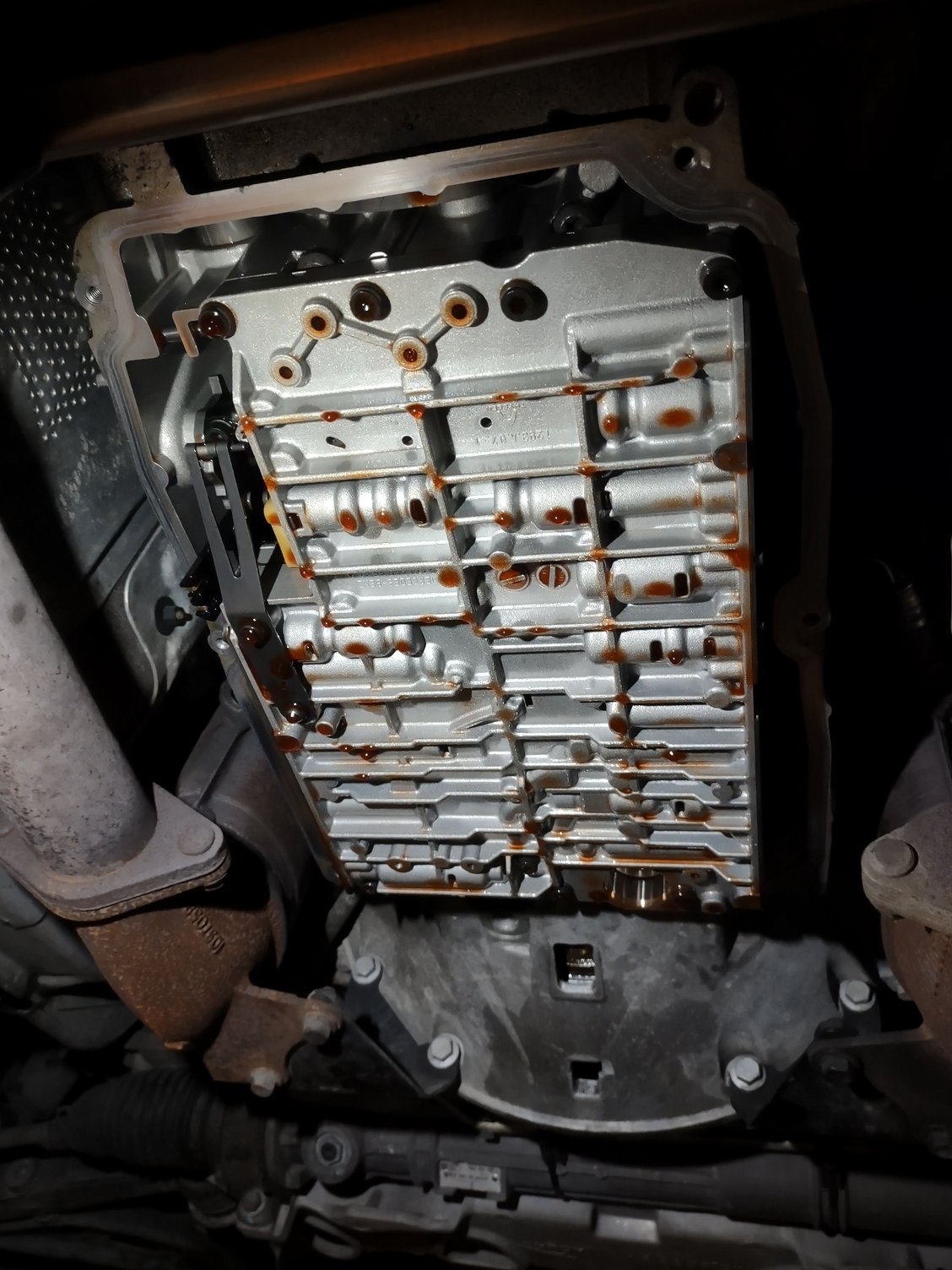

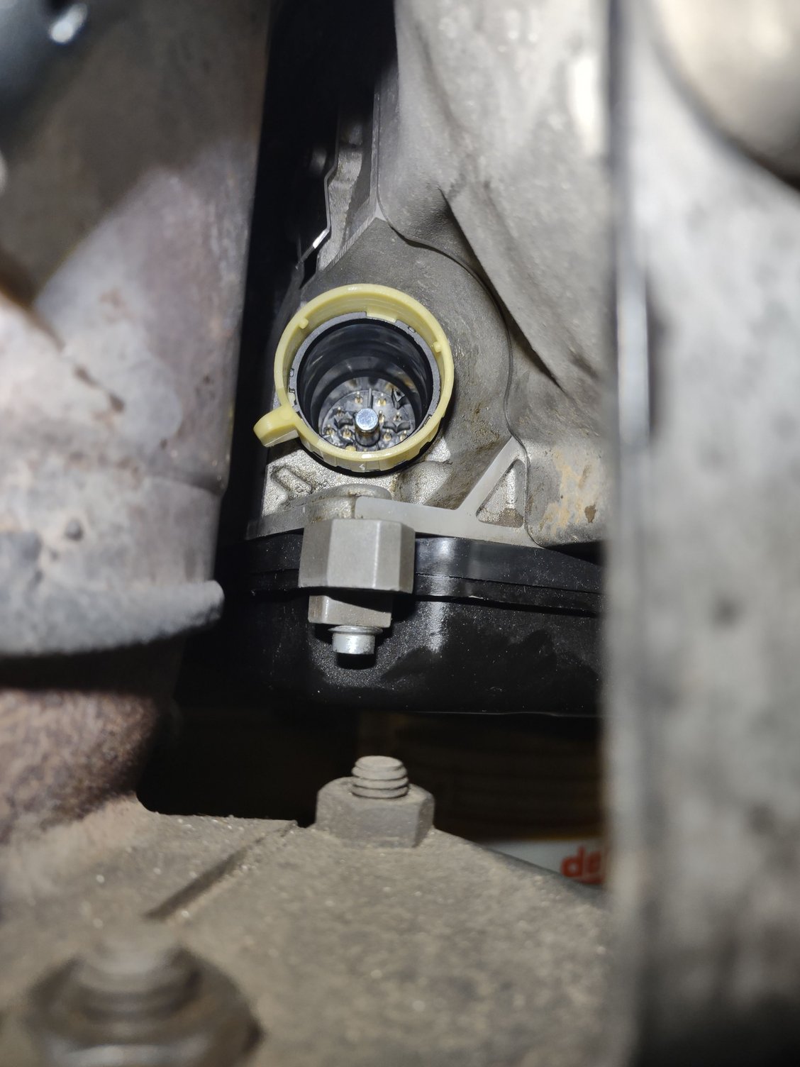

Well, I'm at the end of the job, I replaced the filter, the electric connector (removing the heat shield), the gasket, the bolts and the drain plugs washers. Drained for 24 hours, and the result is a big amount of oil removed, exactly 8 litres. I think I removed all the oil from it. In the event it was overfilled, I put 7.5 litres of Shell ATF134, and tomorrow I'll check the level with the the temperature method. No dirt found in the pan, and the oil was clean and without smell, it was simply the wrong one for this transmission.
