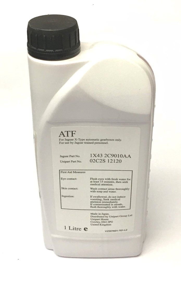

In 2018, by the previous owner, the gearbox of my XKR was serviced by official Jaguar dealer due to a leaking oil pan. The oil and the filter were replaced. In the details of the invoice the part number of the oil they used is C2S12120, I found an image online, the label shows "for Jaguar X type gearboxes only" Now I am a little worried, the gearbox works perfectly, very smooth. Is this the correct oil for this gearbox?
Er... No. Did a dealership really do this? It's supposed to be a compatible fluid for the ZF 5HP24 box, which is definitely not what your car is fitted with.
Zray posted a list of suitable fluids for the Merc 722.6 here:
https://www.jaguarforums.com/forum/x...9/#post2841849

Yes, official Jaguar dealer... . Maybe is it compatible anyway?

The only way to be sure is to find the spec sheet for the oil and compare it to the spec sheet of the correct oil.
The fact it says "X Type only" on it suggests it isn't.

I found a chart online which compares the C2S12120 the same as Fuchs Titan ATF4400. The recommended oil for 722.6 transmission is Fuchs Titan ATF4134. Could the 4400 be a modern superior quality oil, that exceeded the older specs? Or maybe completely different? I'm not an expert about automatic transmission, this is my first car with it (in Italy most of the cars are manual). Since the transmission works just perfect, is there the risk to damage something, running the wrong oil?

Here are the product pages for the two oils:-
https://www.fuchs.com/us/en/product/...ITAN-ATF-4400/
https://www.fuchs.com/us/en/product/...ITAN-ATF-4134/
The 4400 is for Japanese gearboxes, the 4134 the MB unit in our cars. What the actual difference is is anyone's guess. You could always call Fuchs and ask?
Realistically though it's not that hard to do an oil and filter change on the MB gearbox, so perhaps you should look at doing that.

Here in the US I use the SHELL 134ATF
Easy to find in North America.
The C2S 12120 is for the JATCO gearboxes.
Not compatible. They were just lazy and put in any old oil they had on hand.
if I were in your shoes I would never go back to that dealership. And definitely put in the correct oil. Your transmission will work longer, and better. The list of correct oils posted above are not hard to locate. The Shell 134 is reasonably priced on Amazon.
