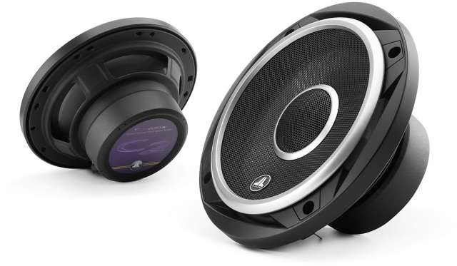

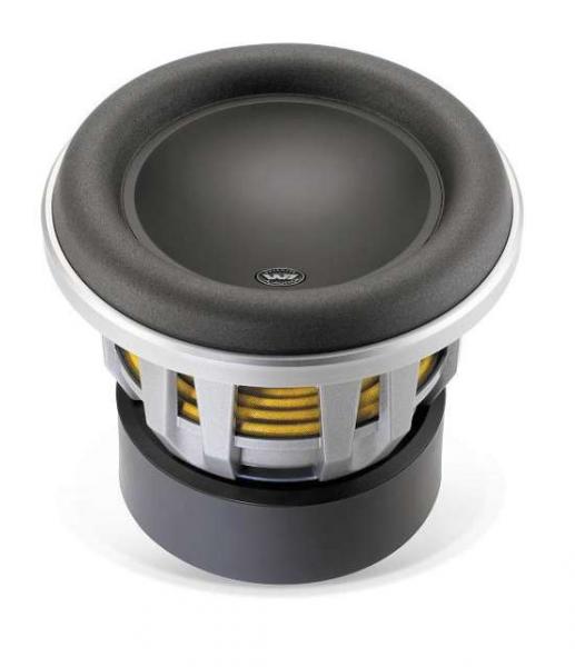

For the speakers I was going to go for JL Audio all round - including an 8" Free Air sub.
Coupe multi-media/audio upgrade-jl-c2-650x.jpg Coupe multi-media/audio upgrade-jl-c2-650.jpg Coupe multi-media/audio upgrade-jl-8w7-3.jpg

I think this set-up would give me a rich quality at less than deafening volumes (I have an exhaust for that!) with the MP3/bluetooth/Nav functionality, and as long as I'm careful not to activate the screen when I'm in 'park' it should be ok too.
