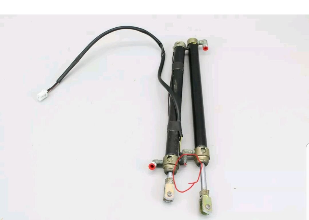

What I've noticed is that the center latch will stay UP looking as of its ready to receive the hood/top until the top is FULLY in it opened position... There are switches in the rams that report to the system when this happens. Sounds like either the switch is malfunctioning OR there is something impeding the tops full OPEN travel....?

I need to find an image of the RAMS (the hydrolics) to see which end that electrical switch (built into the RAMS) is on. Strange thing is,,, I seem to remember it being at the TOP of the passenger side RAM - engaged when the top is full UP.
