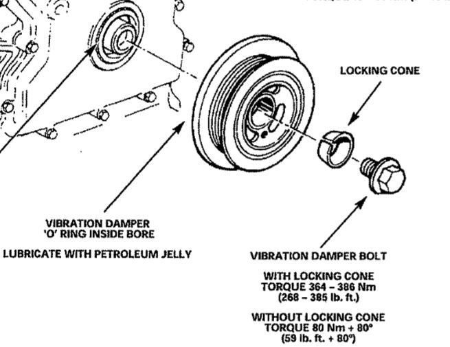

Refitting the crankshaft pulley this weekend. Looking for the torque found this in the engine repair manual. Mine doesn’t have the locking collar so only need 80Nm +80deg but noticed an O ring. There wasn’t one fitted and cant see anywhere it should go. Assume I don’t need one. Any advice before I refit it?
Engine Repair manual

Ended up using some thread lock. My pulley didn’t have the locking collar either. Here’s how I did it, just hope to doesn’t leak. Fitting Crankshaft Pulley -EP28- Jaguar XK8/XKR (X100)

TSB for you.
bob
File Type: pdf
Old May 5, 2020 | 12:37 PM
O&DR's Avatar
Joined: Apr 2020
Posts: 150
Likes: 86
From: Mid Wales, UK
Bob, thanks for the tsb, looks like I wasn’t far wrong, fingers crossed, thanks Damian
