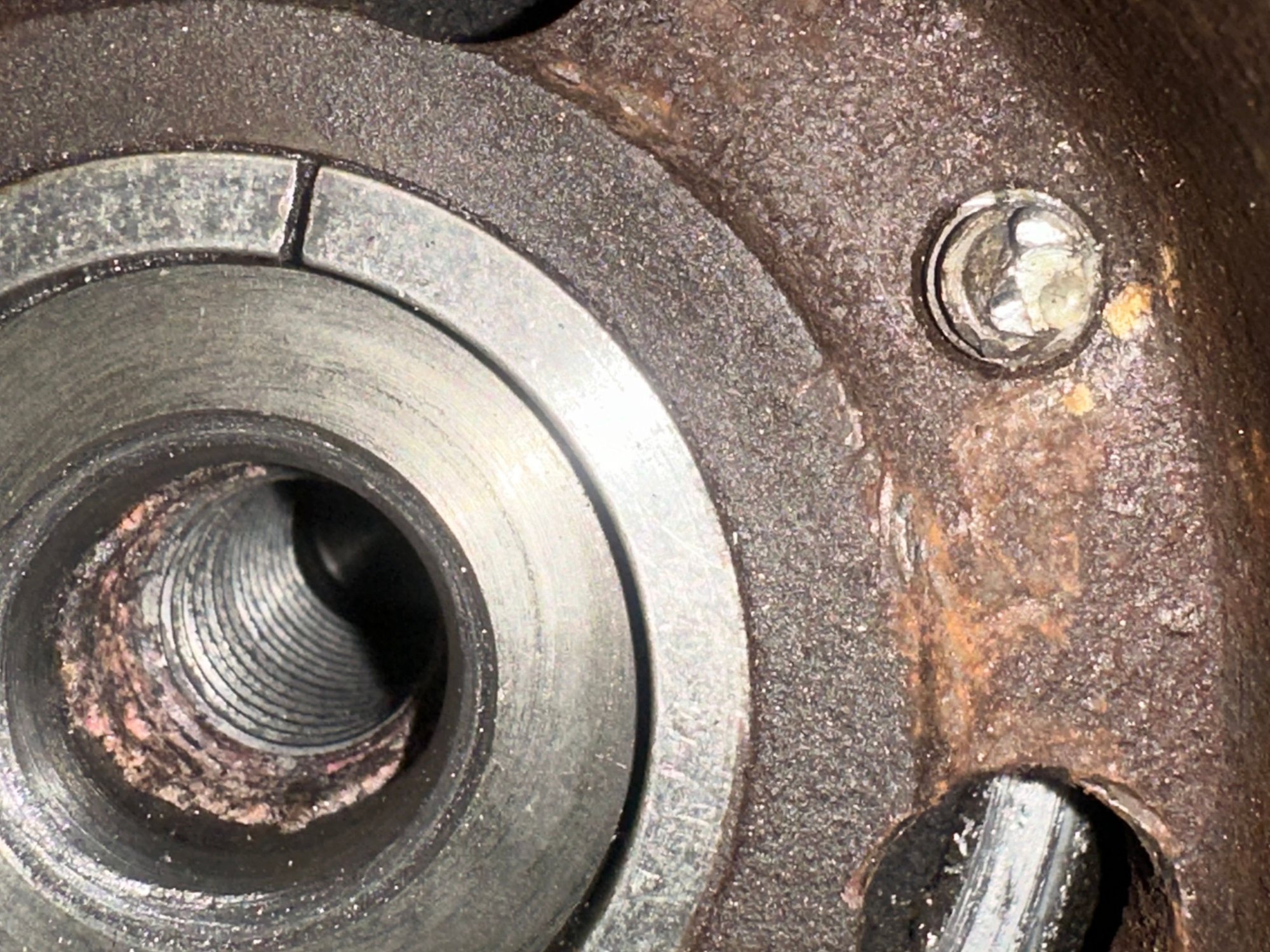

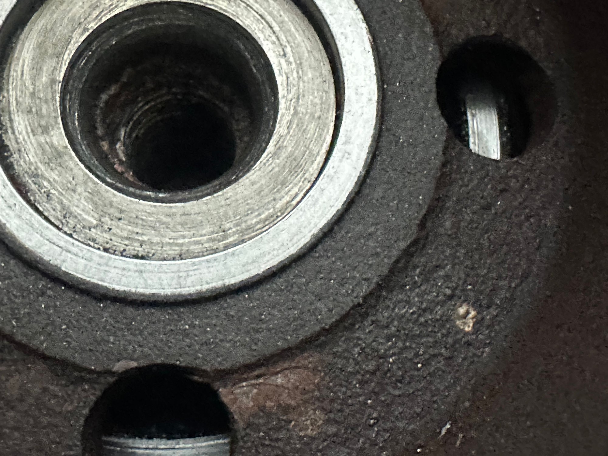

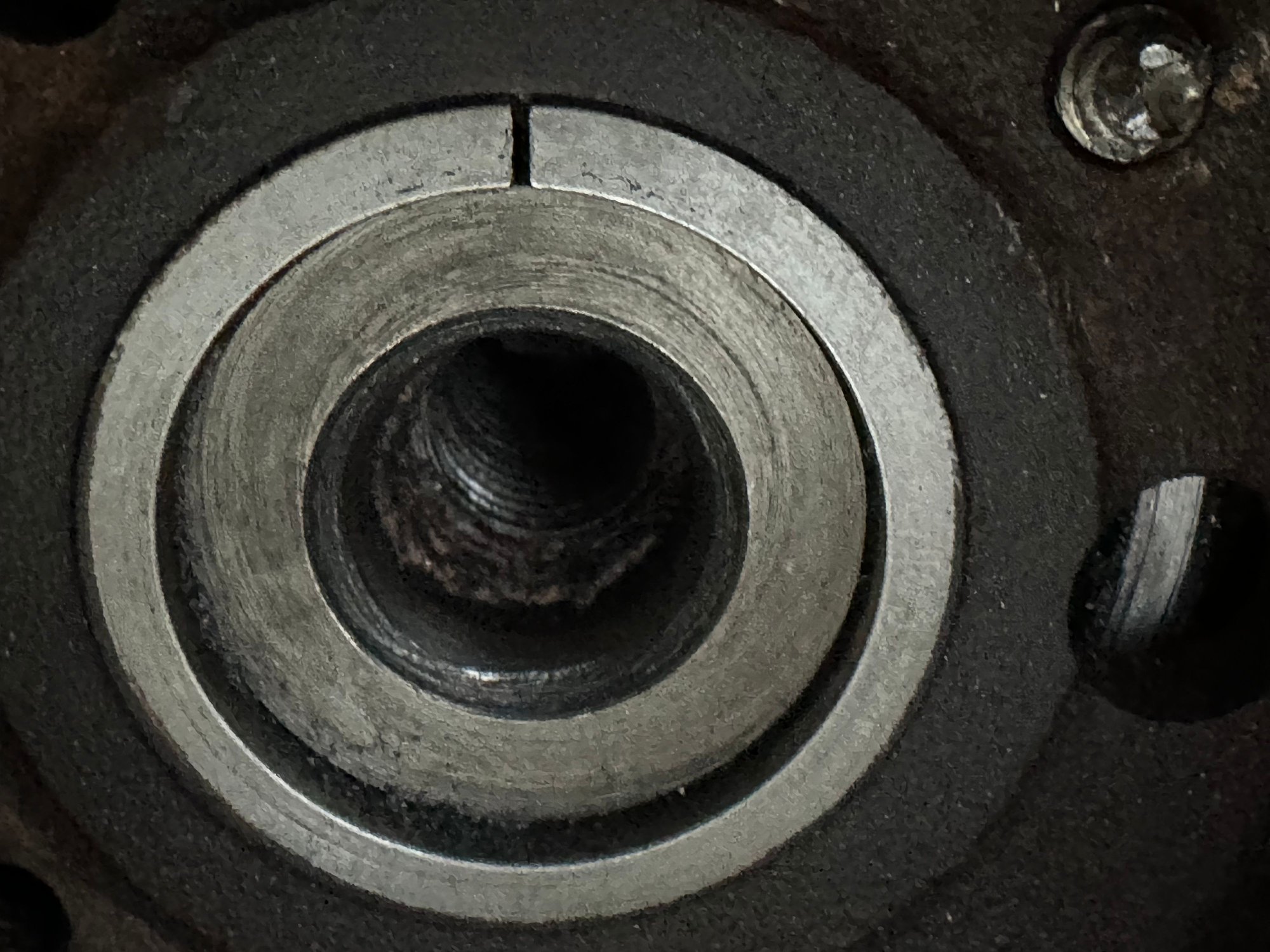

Hi,
Hopefully you guys still reply to this thread. Im not sure if I should keep trying to apply torque to the puller or try to knock the pulley back in. Please see the photo to see the current position of my crank pulley and the tapered collar. At this moment, I have broken one of the bolts on the puller set. Now I have to use the 2 jaws pulley to pull from the outside diameter. I know it could damage the pulley but it’s my last resource now. It looks like the pulley and the collar have moved outward a little and I should knock the pulley inward now. I have tried to knock the pulley really hard but its seems it doesnt move, yes literally knocking on it not tapping. Did I over pulled the pulley too much? You can see the bolt I broke in one of the photo.

Jaguar issued a TSB almost 3 decades ago about removal with the 'split cone'.
