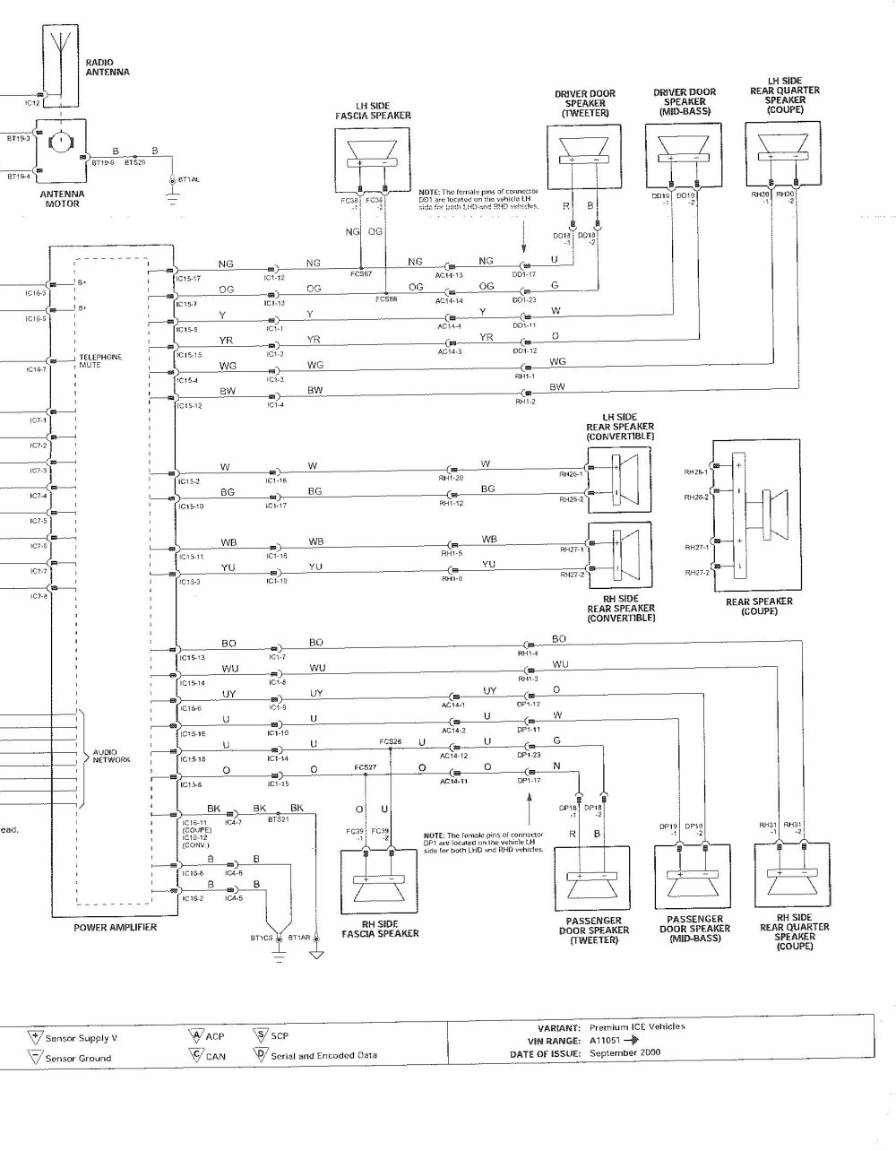

thank you for the information. i have a 2001 convertible with the premium Alpine system. I can hear the subs by modifying the settings at the head unit. Fading to rear silences the system. My initial research and questions asked tells me so far that the convertible has no rear channel for the full range. Given that there is no rear parcel shelf it is logical that the rear speakers cannot be mounted as in a coupe. However, the area where the subs are would be a good alternative and I find it hard to believe that a high-end manufacturer installing an upgraded system would not have modified the install for this situation. Additionally, in a coupe this would also be a good location if not better for additional speakers.
The system is excellent as it is now, especially for classical and anything symphonic. It is one of my favorite aspects of the car when the hood is closed. this will require some further investigation as to what is stock and what my options are while preserving the originality of the existing system.

Have you seen this :
