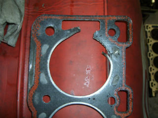

Cylinder head gasket blew on the old (98) XKR. Quite surprised as it has only done 65,000 miles and has been well looked after. What was even more surprising was the gasket blew at the 3rd cylinder on the right bank, but the 2nd cylinder was also damaged and close to blowing. Left hand bank was the same, 2nd and 3rd cylinders distorted at the bottom and close to blowing. Is this normal? Do I have an underlying problem, like overheating? When replacing the gasket is it wise to use Jag parts or are after market parts ok?

There's that familiar looking "ding" in the metal gasket ring... was that a factory issue?
I don't see how that would happen naturally.

What coolant were you using?
I see a reddish tinge in cylinder 3. Dexcool?

I agree with the ding on the metal ring part, LH gasket was the same and hard to see how it could happen naturally. Could the heads have been over tightened and squashed them in towards the cylinder? Took, 5 snap on sockets and 2 pulled shoulder muscles to get them off. Don't know what coolant was but it was red and clean.
