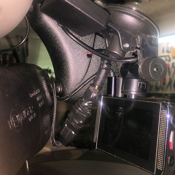

Andy,

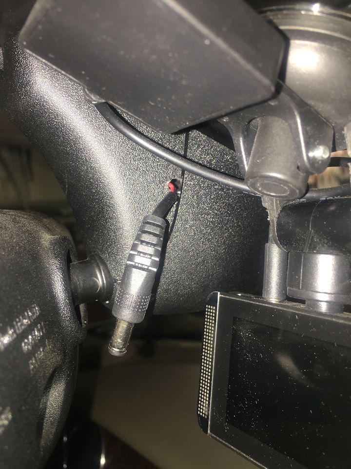

I tapped off +12 V in the panel up above the mirror and mounted the camera on the windshield behind the mirror. Works great and the camera is virtually invisible.
If need be, I'll see if I can find the wire codes. I took the 12 V and made a mini USB adapter for the Camera.

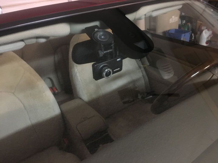

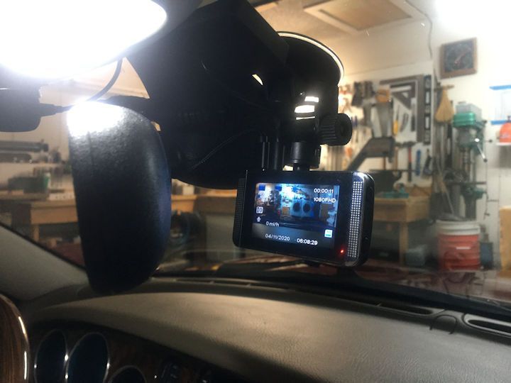

Old Apr 11, 2020 | 09:08 AM
nalle's Avatar
Joined: Jan 2019
Posts: 260
Likes: 72
From: Mesa, AZ
Default Dash Cam
Andy,
Here are a few pics of my top mount.

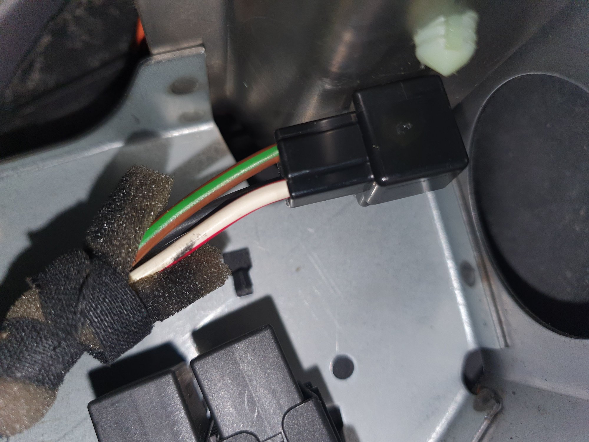

I used the same aux power behind the glovebox. If you take the glovebox out, it's tucked up against the inner wing. It has pemanent 12v, ignition switched 12v and an earth.

It's a three blade plug. It's tucked well out of view - once you take the glovebox out, you kind of need to stick your head into the glovebox space and look back towards where the passenger's outer knee would be.

Is this the one? Wire colors on my Xkr -00 are black, red/white and brown/green
should be the FC51 component accordingly to the electrical guide

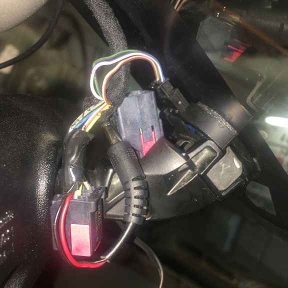

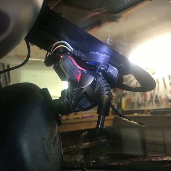

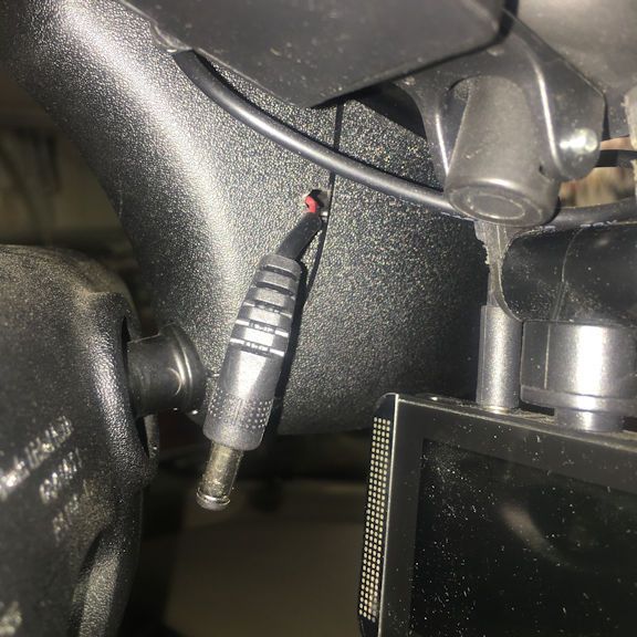

Old Apr 25, 2020 | 10:38 AM
nalle's Avatar
Joined: Jan 2019
Posts: 260
Likes: 72
From: Mesa, AZ
Default an easy connection
Andy,
Switched 12V is already available behind the cover of the mirror mount. Since the powerdraw is nominal for a camera, it works fine. The only problem is that it is pretty tight to solder back up there and there is no way to get heat shrink tubing in. Leaves electric tape, that I hate. However, once back together, it is a well protected location it should be fine for a long, long time.
I made a 12V to USB charger from a mini cigarette light plug. Unfortunately even there I had to use electric tape as I did not have any heat shrink tubing large enough. Once installed everything is well hidden behind the mirror.
Switched 12V+ is on the red/white wire and Ground is on the Black.
