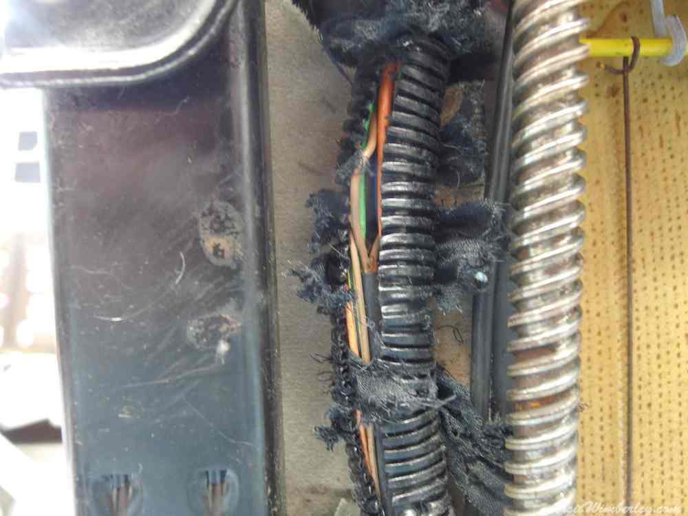

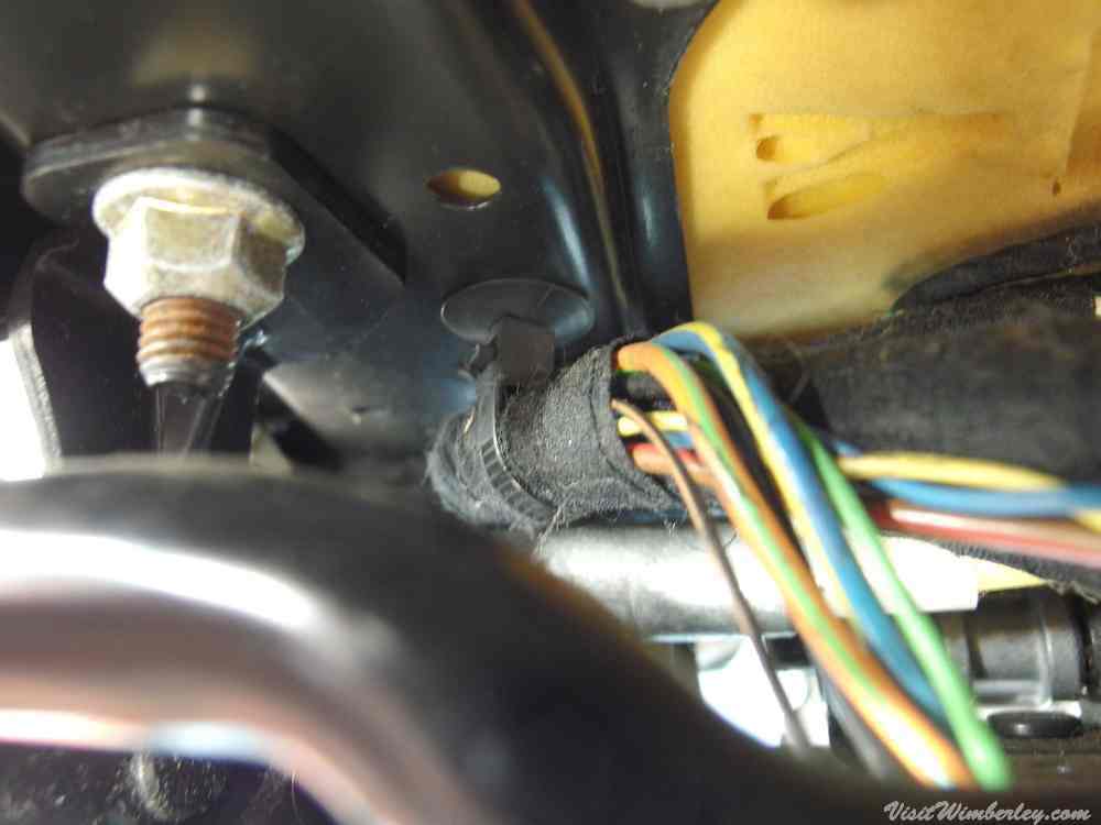

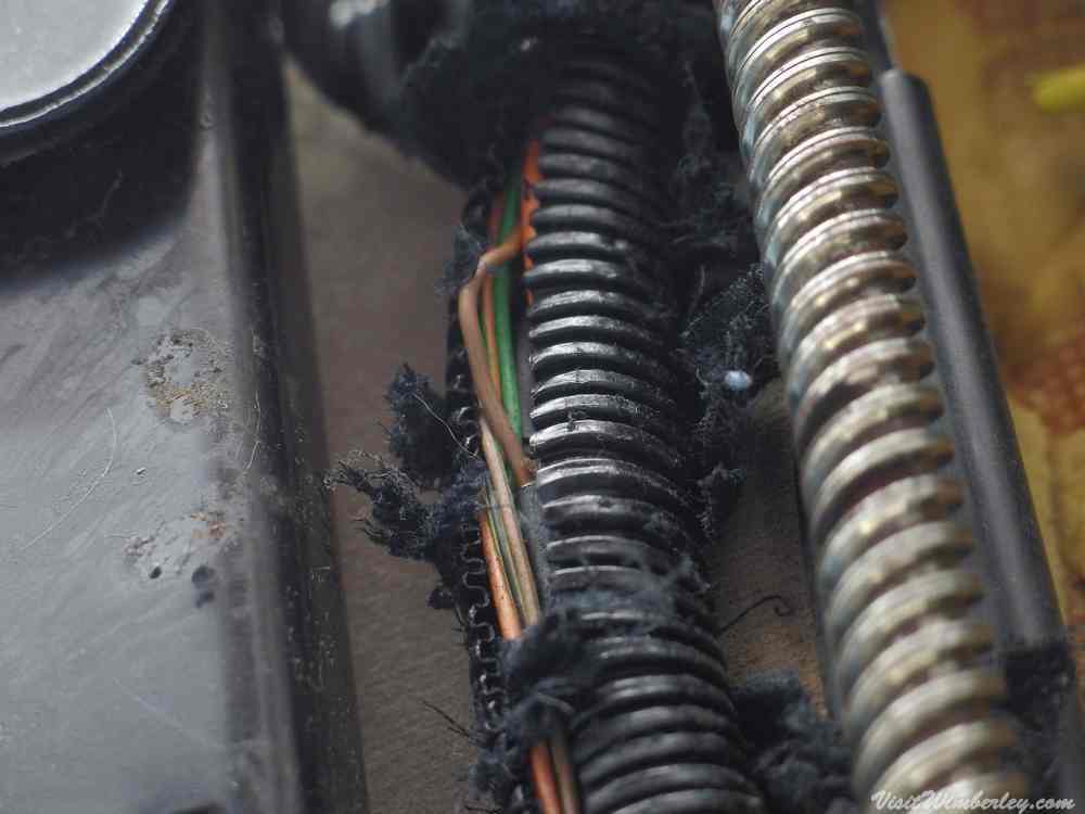

the wiring running along the screw is know to oft times get damaged, check that.
Even though mine was secured it was damaged,
these are shots from my 2005 drivers seat

Thanks for the pics. I did notice my wiring was a bit dodgy. a lot of the black cloth wrap was unraveling. I used electrical tape to secure it out of the way. Perhaps I need to go through it all with a fine tooth comb.
