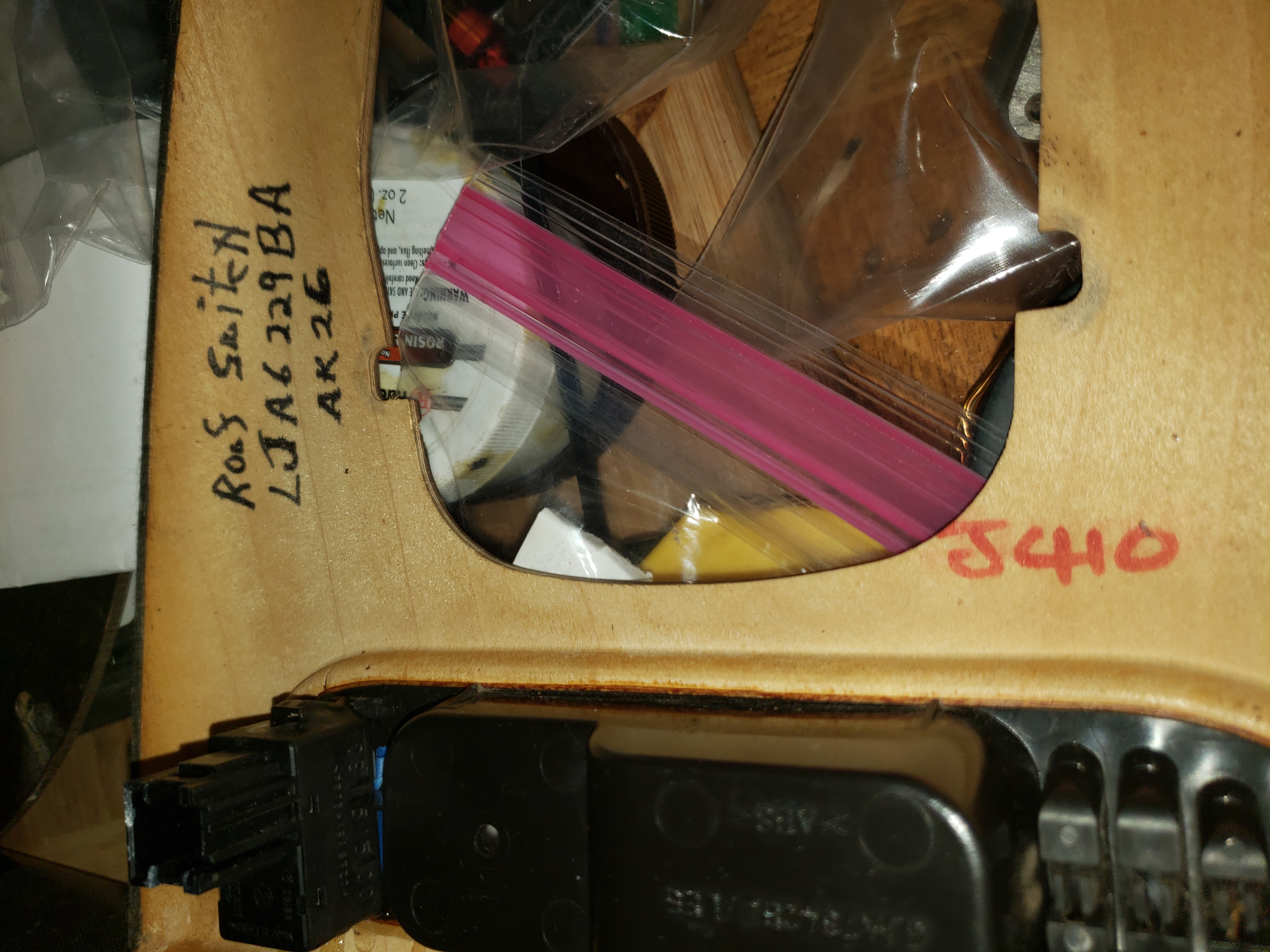

So, my job was to remove any flex in the black plastic insert, then figure out a way to secure the roof close switch in place without accidentally gluing the switch pad your finger touches.
First I epoxyed the surround in place along the edge where it touches the wood. This removed flex. then I judiciously applied epoxy to the switch, leaving a way for me to pull it out if needed down the road. (It gets real dirty dusty down there, its gonna work its way into the switch someday I bet)
I was worried I had a bad switch, so this is a good thing.
The photo shows my handwriten note of the switch's part number in case any of us ever need to chase one down. LJA6229BA. AK26 is on a line below that.
