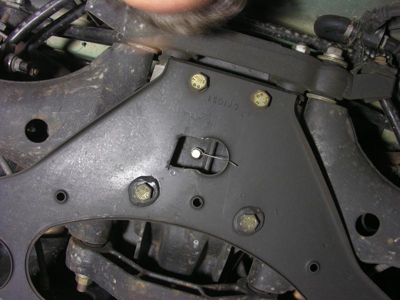

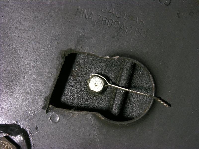

Pics that help from member Cheaperts
And this link with pics from member Race Diagnostics.
https://www.jaguarforums.com/forum/x...iff-oil-71492/

To be clear, the fill plug is not on top ... that would be the breather vent.
The fill plug is about 1/3 of the way up the rear cover and to the right of center.
One way to think about changes is that the access for both checking and filling is the same. Through the fill plug. Once you are in there to check the level, you might as well go ahead and change it.
