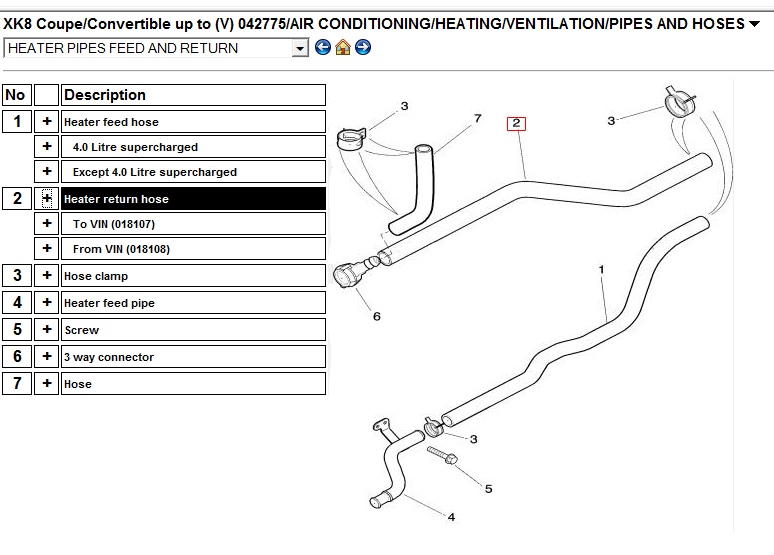

If it was the heater core, the coolant would most likely be leaking out inside the car.
As it's at the firewall, it will probably be one of the two awkward hoses (items 1 and 2) under the manifold.
A lot of dismantling involved to access them so definitely worth replacing BOTH.

No water whatsoever on the engine or trailing down either pipe. Definately "All" the coolant coming from the grommet on the firewall. Took out the glovebox to get a birdseye view of where the rubber grommet came from and it was the end of of a hose connected to an aluminum pipe. The grommet was ribbed to make the turn where it attatched to the firewall.
