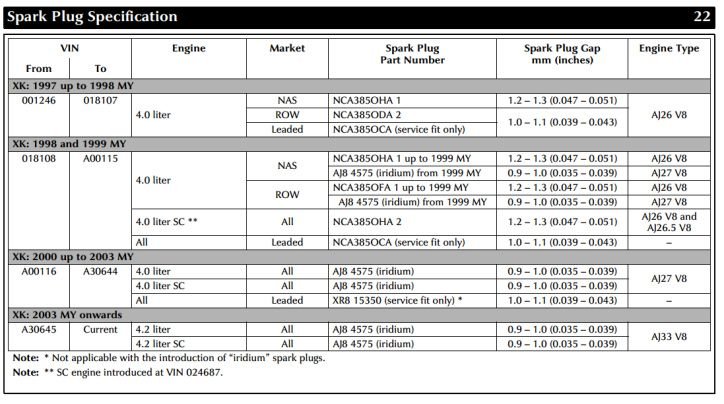

Spark plug types and gap requirements have changed with the year and engine type. (See attached)
Also the Iridium plugs have a much smaller gap requirement.
What Jon89 has reported is the usual outcome when checking correctly fitted Iridium plugs, they will easily last over 100,000 miles.

Originally Posted by Hazmat1075
Ok, for my 2005 XK8 VIN X52A43421 what would be the recommended Spark Plug and its gap? The provide info shows 2003 and onward....would this be for mine?
The 2003 model YR onwards information is correct for your car and all 4.2 XKs up to 2010 MY, including the XK150 AJ40
