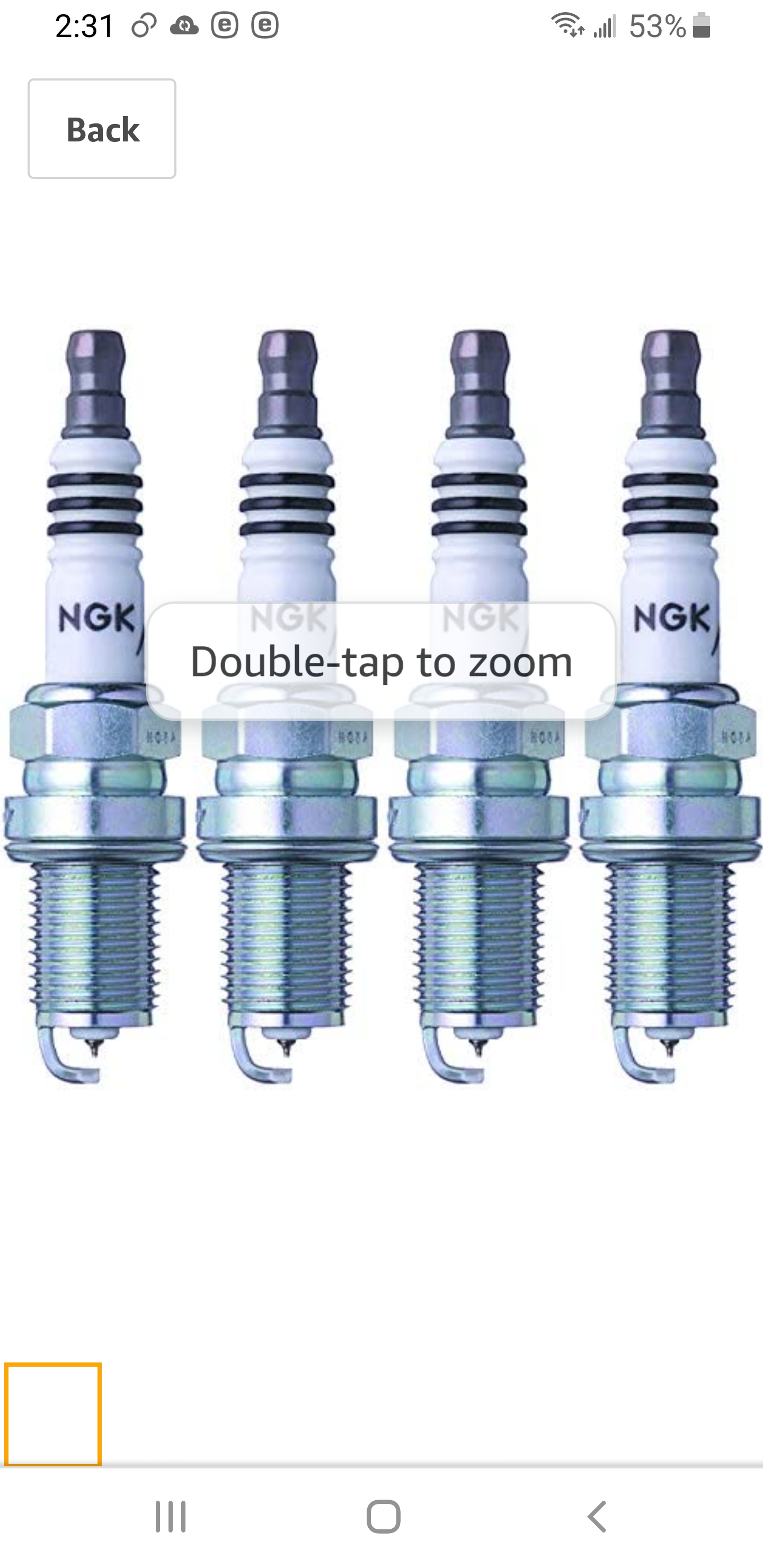

Default Yes they are iridium
Avos,
Ok these are the guys I used. I could have posted my used plug, but that'd be redundant.
I've no clue why they wore like they did, but engine is running fine. Maybe its this brand / model that one should be wary of?
John

FWIW, I just looked it up. The worn plugs went in 6 yrs ago at 71,000 miles. So the photo i showed of the worn plug is 6 yrs old 65,000 miles.

The ones you show for sure do not have a platinum tip, so are not the long life ones.
Here is some info from NGK:
https://www.ngk.com/how-long-do-ngk-iridium-plugs-last
These have an (avg) life expectancy of about 40-50K as they state, though driving conditions it could be longer. You may well gave fallen in the 40-50K range, so that could explain the wear.
Overall I don't think its a bad idea to check your plugs once in a while, but if you want long life best to use the NGK IFR-5N10 ones, these are for sure proven.
Good that you posted, am sure there are many who have bought shorter life iridium's thinking they would last.
