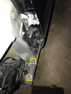

Assuming you’ve already got the wheel off and fender liner out, remove the foam pieces at the rear and top. There are three bolts with 8 mm heads that go up from the front lower cowl into the fender – see yellow outlines in pic below (that’s the lower cowl with the fender removed). Pull the hose out of the washer reservoir and rotate it out of the way (have a bucket ready). You’ll also need to remove the marker light (simple push-out) to get to the center bolt.

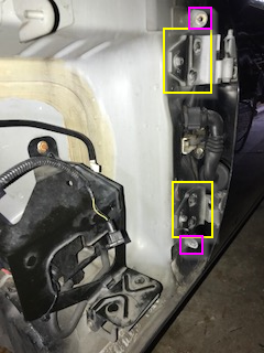

Remove the two 10 mm nuts that hold a bracket – see the magenta outline in pic above. The headlight assembly is right next to these and the only way I could get to them was with a ratcheting 10 mm box end wrench, although it may be more feasible to undo the other end of the bracket – I didn’t explore that possibility. Now remove four bolts with 10 mm heads at the rear. Two are visible looking straight back toward the door – see the magenta outlines in the pic below (the yellow outlines show the door hinge bolts). You’ll want a good 15 to 20 inches of extensions for those so you can get the ratchet/power drill out where it’s easily cranked.

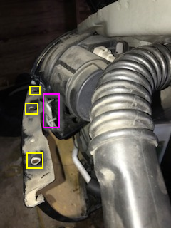

Now remove the two lower rear bolts with 10 mm heads – see the yellow outlines in the pic below (looking down from above with fender removed). The front-most one is easily visible with the fender installed; the other is behind the vent purge valve stuff and you’ll probably have to do that by feel using a 10” to 12” extension and a ratchet. No doubt you’ll want to remove the marker light there as well.
