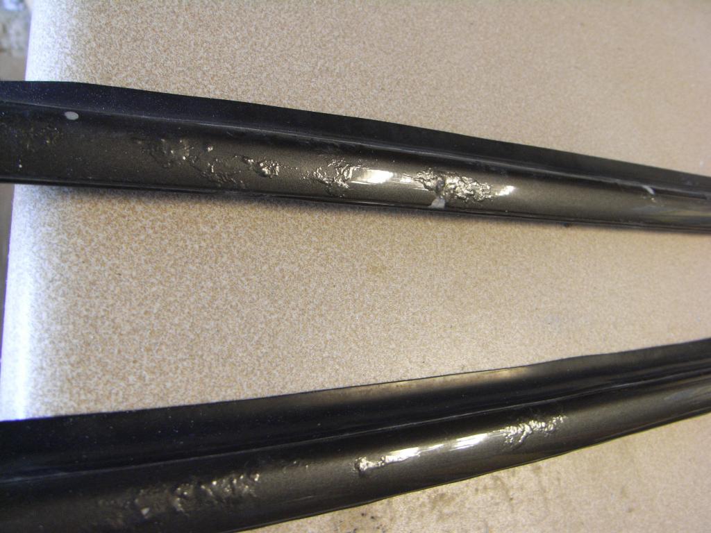

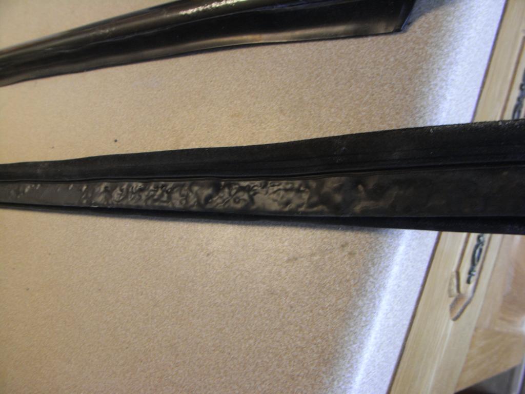

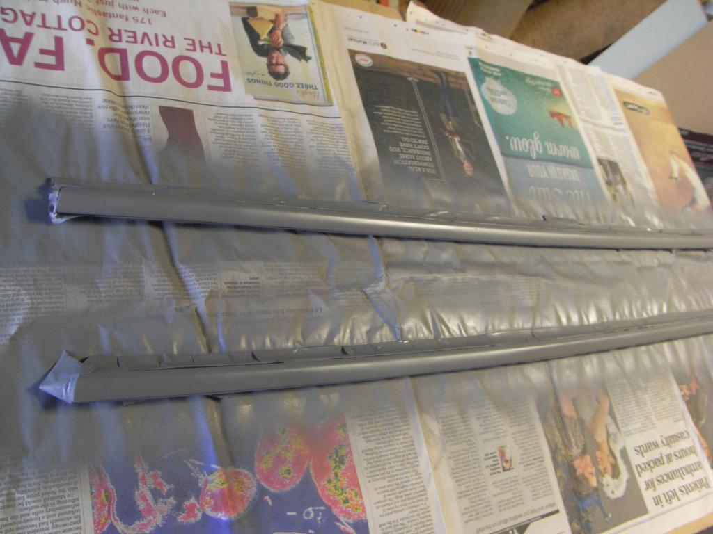

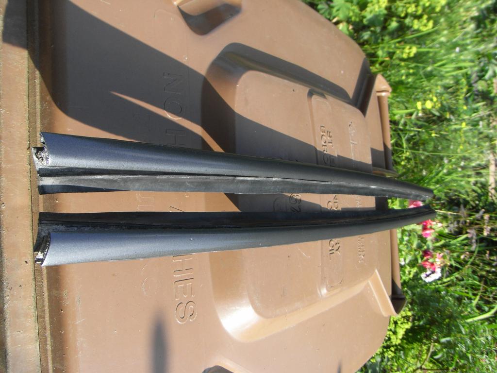

I had a similar problem with mine. Not only had the outer face corroded, the metal bonded within the rubber had corroded and I thought they were only fit for the bin. With nothing to lose I had a go at repairing them. In parts, the rubber had 'blown' away from the metal, which had corroded badly. Where I could, I prised the rubber away from the metal and removed as much of the powdery corrosion as I could. I then stripped the paint from the outer metal and primed with etch primer, before a top coat (Dorchester Grey) and lacquer.
After a couple of days, I bonded the rubber back to the metal with contact adhesive. The result is not perfect, but it is a lot better than it was. I will see how long it lasts.
The following photos show the problem and the process:
