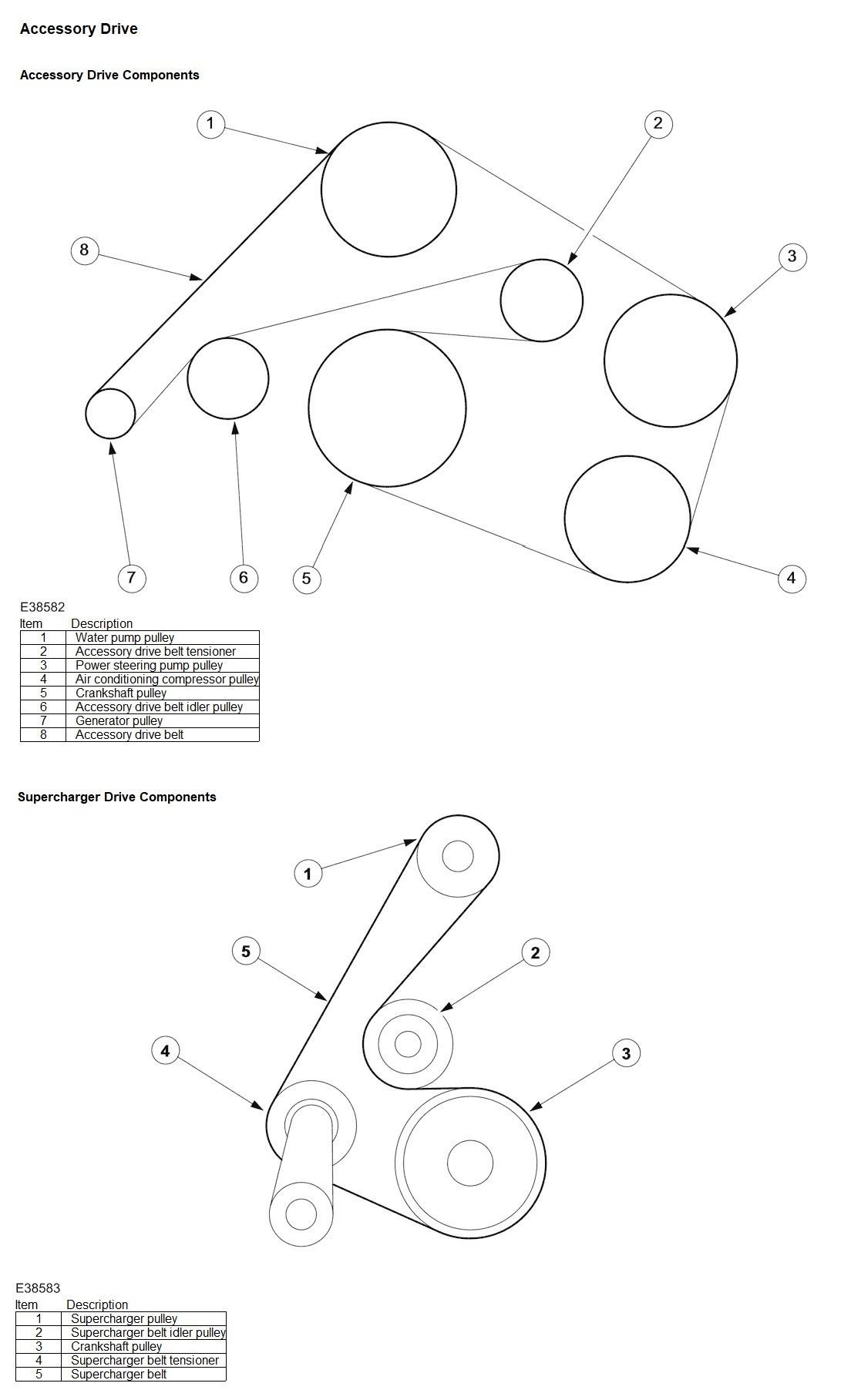

Are you 100% sure the belt was routed correctly? Use this belt diagram for reference.
This would be my first step before buying a new belt.

I can definitely confirm that the belt is routed correctly, but many thanks for the diagram. I did the serpintine belt a couple of months ago when I did some maintenance on the cooling system so could get plenty of access after removing the radiator.

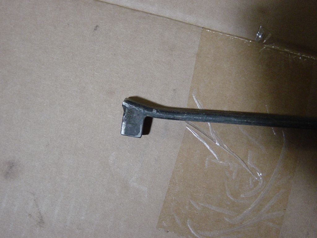

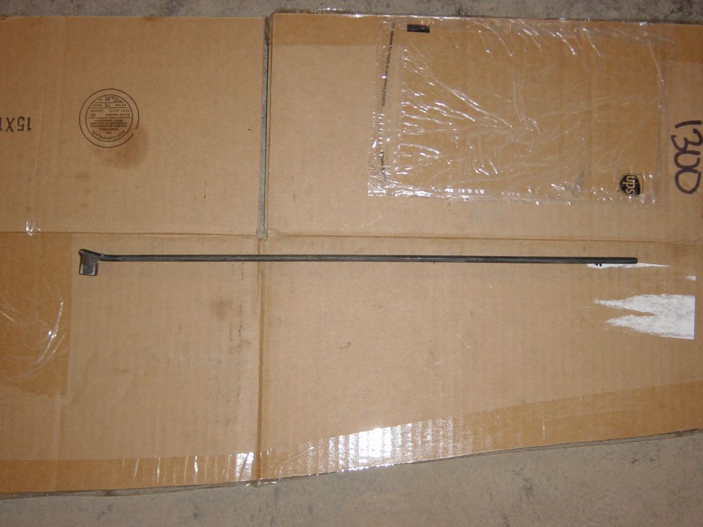

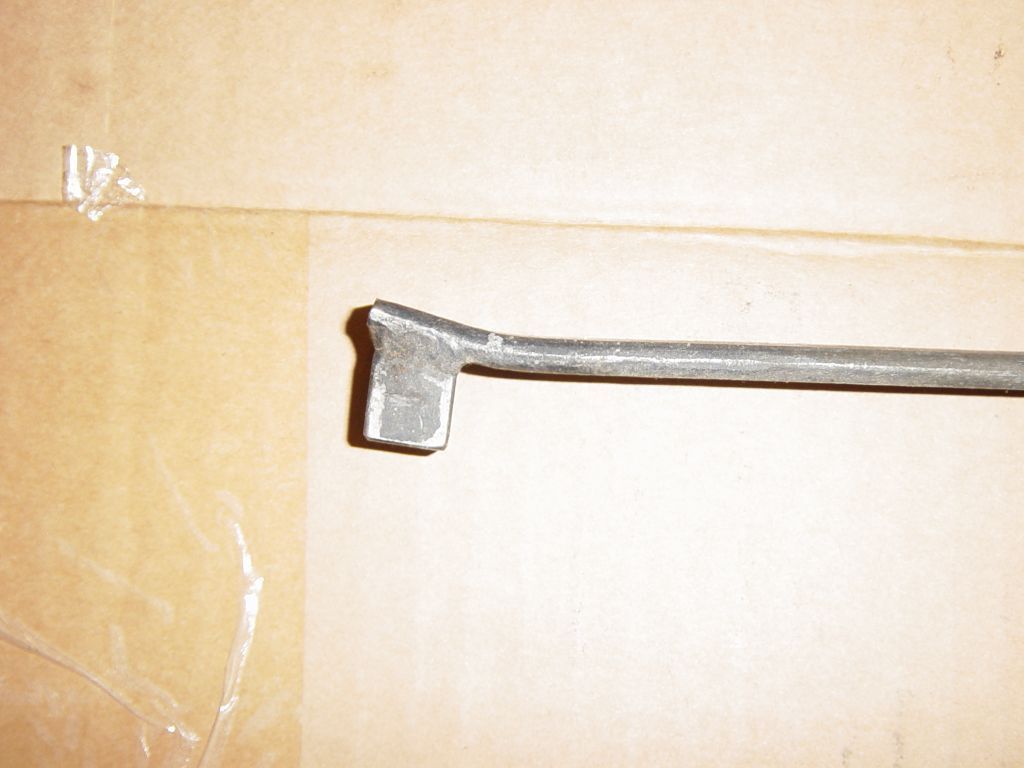

Just now I'm doing the supercharger belt with everything in place using a tool I made up myself (basically a bar with a bolt head ground down to a 1/2" square drive welded to the face) so that I can do it without removing everything again at the front of the engine.

We were issued a 'special-tool' when I worked at the dealer so I 'sorta' replicated it.
A piece of 1/2" square stock welded to a flat bar but you should bend the end to engage the tensioner at the angle.
