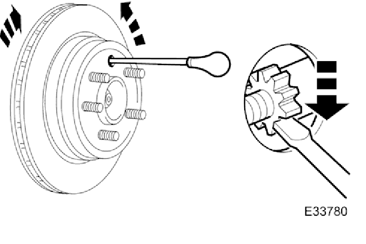

Thanks for the reply. seems I didn't need to remove the nut for the drive axle.Also,does the car need to be in neutral? Someone noted that the parking brake is applied when vehicle is off and in park.Finaaly.do I need to remove the 7mm plug on the face of the rotor? thanks again

Yes on the plug, it's holds it on and I thought it was a 6 MM, go figure. I think we have always just had the car in park. The hand brake shoes are adjusted through a hole in the rotor and hub, a circle gear type, like on most American ones, it's just near the top and a little to the side. A normal screwdriver will do the adjustment, if needed. Our parking brake needs to be applied with the lever by the driver left hand, some other models have an electric one, but even then they must be applied by a pull switch. A motor pulls a cable to put it on, we are just over run things that go bump in the night.

Just to add, you need to loosen the emergency brake via cam mentioned above before your try to remove the disc (rears), rotate so tab cover is 12 oclock then using the screwdriver turn it clockwise to loosen, after replacement readjust as necessary turning it anti clockwise.
