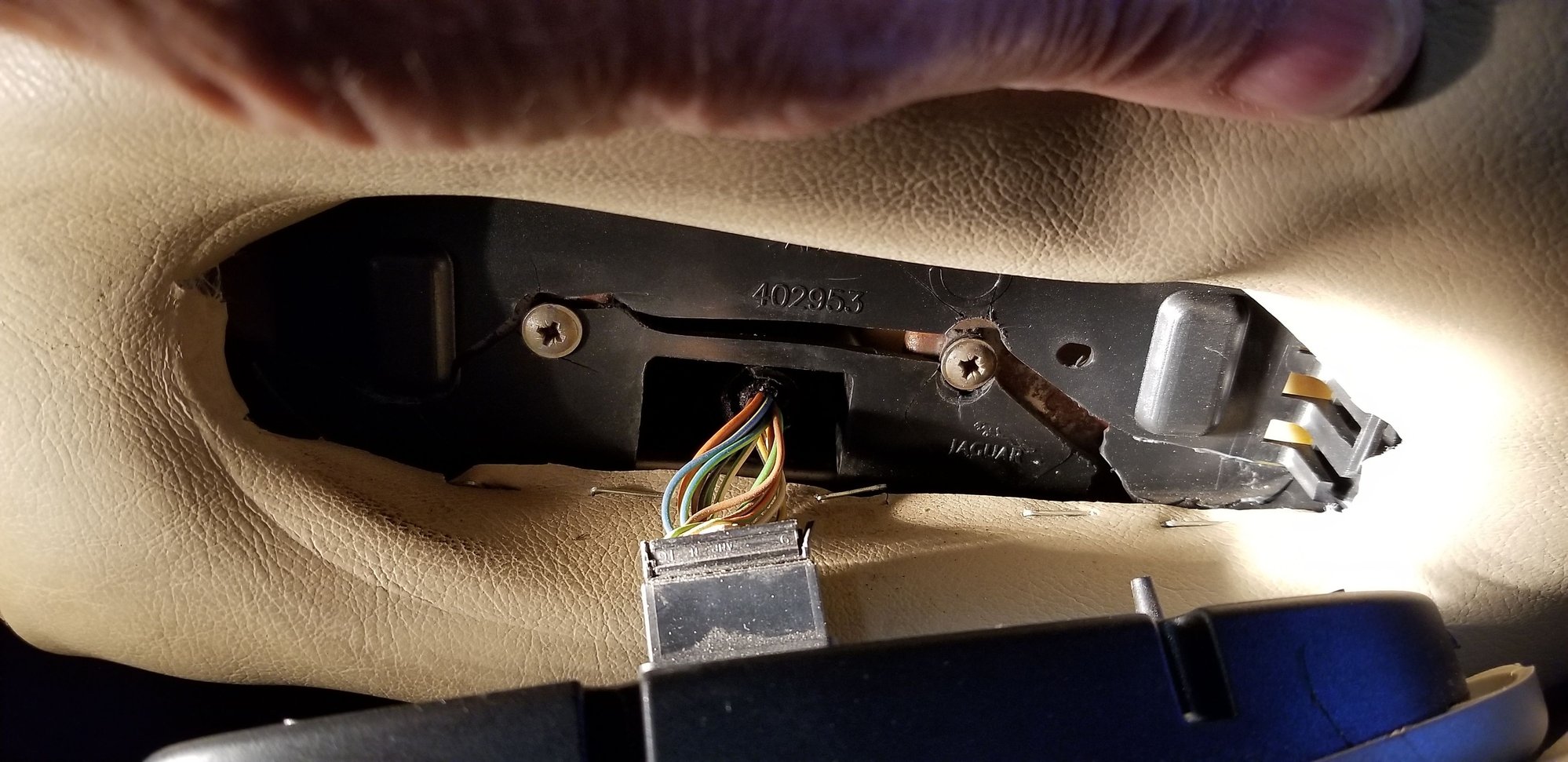

I have been putting up with this problem for a few months now. Not terrible as I'm the only one who drives the car (XK8 coupé 2006); however, my wife and I will be taking quite a long drive in a couple weeks, to attend the international Jaguar festival in Santa Barbara. I might need her to drive some. One particular annoyance with this issue is that the seat control pod hangs out in the way of grabbing the handbrake lever.
The edges of the pod appear undamaged, the catch ears apparently intact. I assume that my only real fix option will require removing the seat to find what's broken on the side of the seat squab
. Short of that, any great ideas for a temporary fix, for the trip? One that won't do any permanent damage, that is.

Old Oct 20, 2018 | 04:21 AM
Likes: 17,009
Is the front locating tab definitely intact? Difficult to tell from the photo.

The plastic inner housing is broken if that tab is in place, common issue and imo was a poor design as with time and getting in and out it always breaks. The housing is part of the lower seat cushion foam bonded at the factory and would have to replace the foam if even still avail or rigged

Thanks all and especially Graham! A picture is indeed worth a thousand words. As soon as I saw that illustration I was pretty sure no tab that large existed on the front of my pod. Sho' 'nuff, it's broken off.
I tried to add a pointer to the broken tab but all attempts in the crude art software on my phone were hideous.
I now think I can cut or grind off the rest of it, make a new tab, glue and screw it in place, and pop the pod back in. I'll think on it a bit, look around at materials I have available, and see what I can conjure up. I'll share photos of my solution and of course if anyone here has done this and has suggestions and/or pics, please do share.

Alas! A closer inspection revealed complications and the root of the problem. I was checking the latch on the other end of the opening, in the side of the seat cushion. First I found that a corner is broken off the twin receiver slots (plastic) for the latch at the rearward end of the opening. In the process of imagineering a solution to that aspect of the problem, I discovered that the whole plastic assembly is badly broken.
Anything I do to fasten the ends of the pod in place will probably be undone the first time my fat rear leans on the outer seat side bolster. Ugh! Looks as if I need to significantly reconstruct the side structure of the seat, i.e. a metal plate to replace or reinforce the wimpy plastic structure.
Any suggestions? Thanks all!

I like that idea, too, brutal, and even have a long roll of just the sort you describe. I will still however need to rebuild the broken down stupid plastic channel that is supposed to support the seat side bolster.

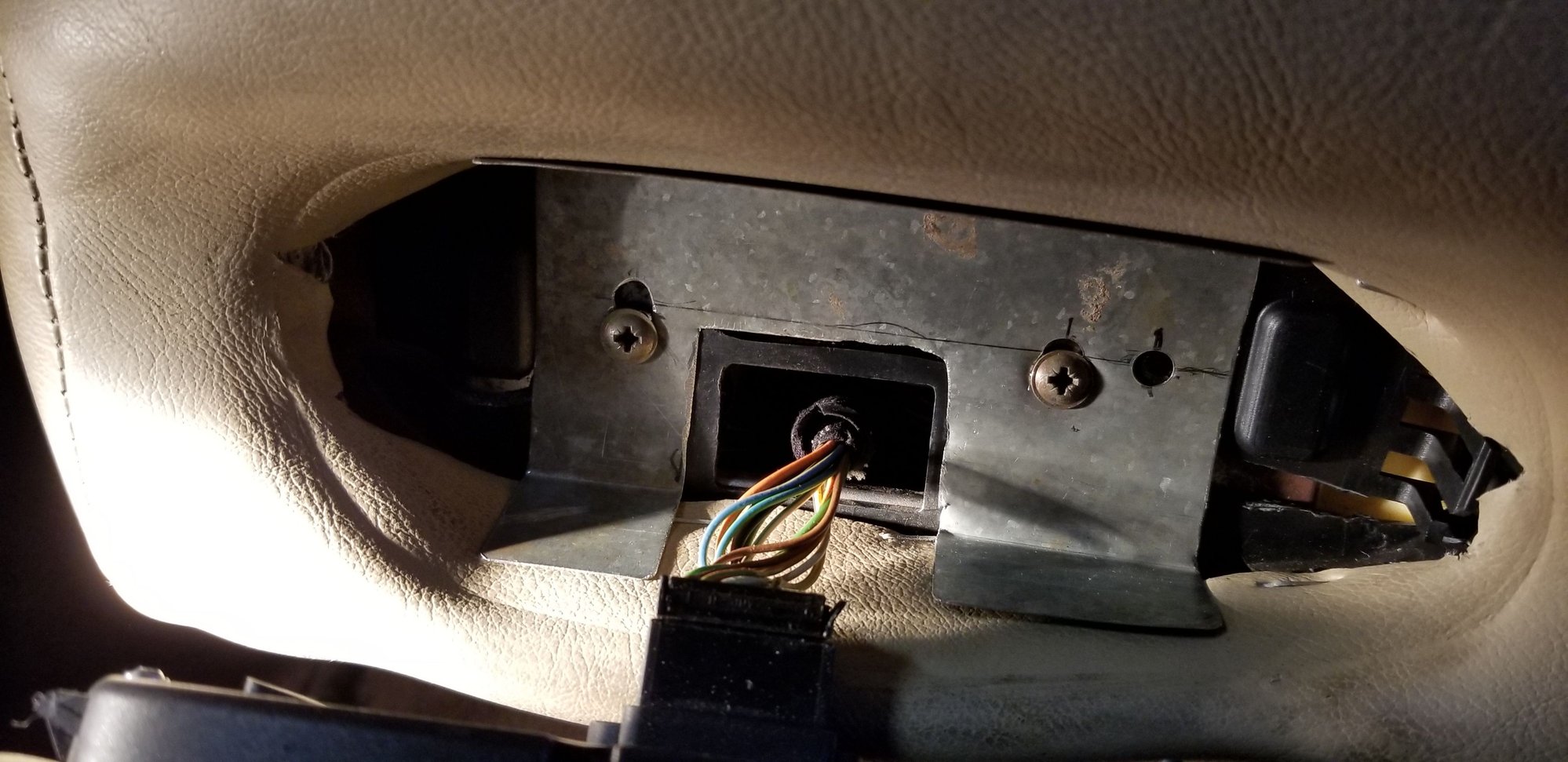

I cut up an old galvanized steel step shingle (for roofing) to make a U-shaped channel to reinforce the broken plastic one. Appears that I perhaps made it a wee bit wide but made it fit anyway (i.e. it spread the broken plastic channel out a bit so I had to elongate my screw holes a bit to get things to line up). I ground away the remains of broken plastic tab at the front of the control pod and added a 1" sheet metal screw, per the excellent suggestion. The pod snapped back into place and stayed put so I'm leaving it for now. If it starts popping out again, I'll probably try the magnet or velcro solution. Both sound to me like good solutions.

Pod snapped back in
Sorry, forgot to take shot of the screw in the end of the pod. Didn't actually expect the pod to snap in and stay closed.
