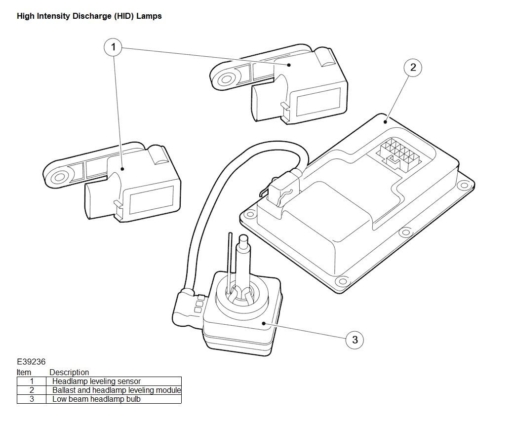

A vehicle fitted with HID's can be identified by the presence of a ballast and leveling module:
I don't have a photo of the engine compartment showing the headlamps but think I'm correct in recalling the levelling modules are visible at the back of the headlamp units.

If you have his headlights wouldn't the bulb give it away? I've got xenon on my car (aftermarket addition). Looking at the profile of the bulb, you can see an insulated high voltage wire running parallel to the bulb casing. This attaches to the tip of the bulb and transmits high volt electricity to get the bulb started.
