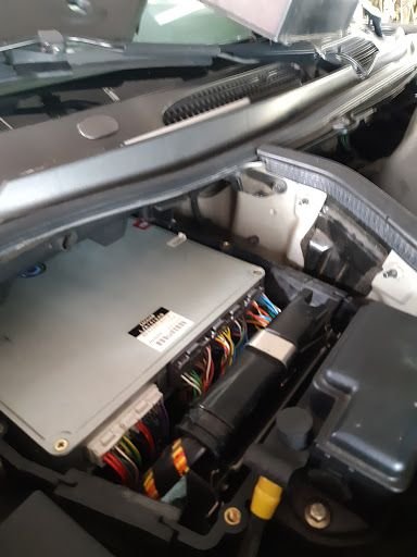

Hello All!
I've been off the forums for a while as my 1997 has been running perfectly for a long time now. I have been fortunate to be able to help some new XK8 owners in my town with the expertise I have gained from this forum. I have also suggested to them that they join as soon as possible to start their learning curve process.
Problem: About 2 weeks ago the engine started running rough and stalling every once in a while. Sometimes it would even accelerate without warning. Some time ago I did some motherboard repairs and shared the results with this forum and since the symptoms were similar I inspected the ECU but could not find any failed components. I eventually sent it out for professional inspection and repair and the job was performed quickly, replacing some components and fixing broken traces. On plugging it back in and starting the car, the symptoms have not changed.
The engine will start but quickly starts to lose RPMs and when it is almost ready to stall, it comes back to life again only to resume the dropping RPMs and eventual stall. I can keep the engine running by feathering the accelerator and even drive it around the block but it is running terribly and stalling without warning.
Up until this happened the engine was running beautifully and still does every few engine starts.
Does anyone have any thoughts? Is there an intermediate step when reinstalling a rebuilt ECU? I would check for codes but my OBD2 can't communicate.
The battery is new and fully charged. The MAS system was cleaned about 3k miles ago.

A repaired ECU should be plug and play. Checking for codes is the next step.

It is my understanding that the new ECU must be married to the Security Module Via IDS in order for it to work.

If the original ECU is repaired by an outfit like ASI it's plug & play. I had the one on my 97 repaired by them. I also had the ECU from my BMW repaired by another company last year, also p&p. If you use a ECU from another car it does need to be paired.

This was my original ECU - I sent it to Module Masters in Idaho. They replaced some components and made some trace repairs and sent it back, so I am assuming it has its original programming.

Yes if you repaired the original unit then it is Plug and Play if not it must be programmed to the car.
