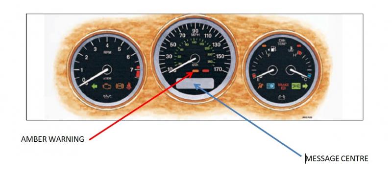

Here's the Instrument Pack with all the Warning Lights:
Is it the Amber light (arrowed in red) that's lit together with green text in the Message Centre (arrowed in blue)?
If so, what does the message say?

I am almost certain she is referring to the amber warning 'oval' and the electrical fault message text appearing below it. I've had that happen one time, in stop and go traffic, while manually shifting the gear box...so I stopped that in a jiffy. I hate electrical faults. Nothing ever happened again, so I can't say I found why mine gave me that message in those conditions. sorry.
What others will probably recommend is going to all of your primary grounding points..in the boot, in the engine, in every fuse box, making sure all hot and ground connections are tight. If you want the electrical schematic with those key locations, we can probably get them up here on a PDF for you, and you can take these to any independent mechanic...no reason to go jaguar, especially if they didn't take that path as part of their diagnosis. Of course, a battery would be my first response also with your random system failures and unpredictable messages.
